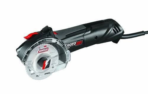

Whatta you mean, sliced it with a zip cut? I'm drawing a total blank here.....

I'm thinking this...

Yea angle grinder with death wheel (zip cut blade)
I clamped the coupler in the vise.
Marked with a sharpy how much I wanted to cut off. Zip cut blade cut thru the rubber and steel with ease.
Then I flipped the coupler over and finished the surgery.
Then drilled the holes deeper so the Allen head bolts were flush.
