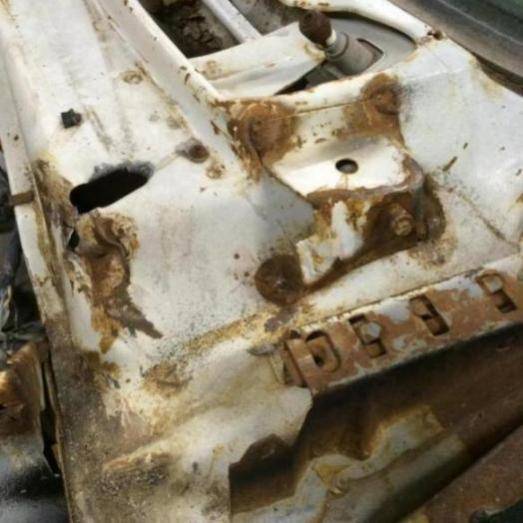

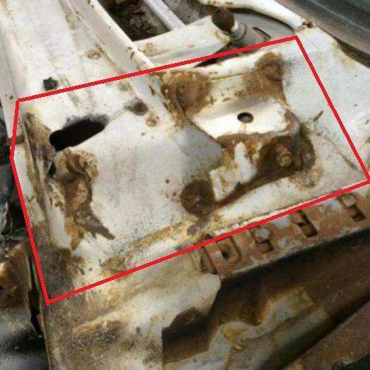

When u did your firewall repair did you use the 4 door for parts? If so do you still have the 4 door? I need the drivers side patch for my wife's 65. I have a 66 2door parts car but not to excited about cutting up a 2 door. But if you don't have the 4 door I may have no choice? Let me know please. And if so what would you want for it.
This is the spot I'm talking about. This car was hit once and messed up the hinge mount pretty bad.
Basiclly just this part. Around the curve at front with lip along fender mount and around to wiper mount. Dont need any part of wiper mount.

Haven't checked in awhile but did you see if you had that piece of the cowl? Drivers side?
and the quarter is looking good!
I do have it, but I haven't had the time to take a detailed look. Work and getting my boat ready have absorbed my time lately. I hope to finish up the boat for the season in the next week or so and will get back to finishing up the car.
