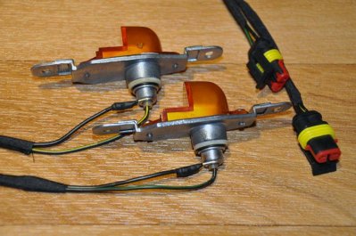

After standing around looking at the car last night, we have decided it needs a full repaint. There are a lot of imperfections in the current paint job as well as some poor bondo work. We will also be replacing the rear quarter panels around the wheels. We discovered a ton of bondo and have decided to get this done correctly. I would love to just paint the front but I would hate the way the back half looked. A lot more work but it will pay off. Also, does anyone know where I can get this connector? My turn signals plug into it.
I should have a good used one. I'll look.........
You could also use "weather pack" connectors. I used them on my turn signals. Thought it's not a bad idea to use modern sealed connectors while redoing the cables anyway!
