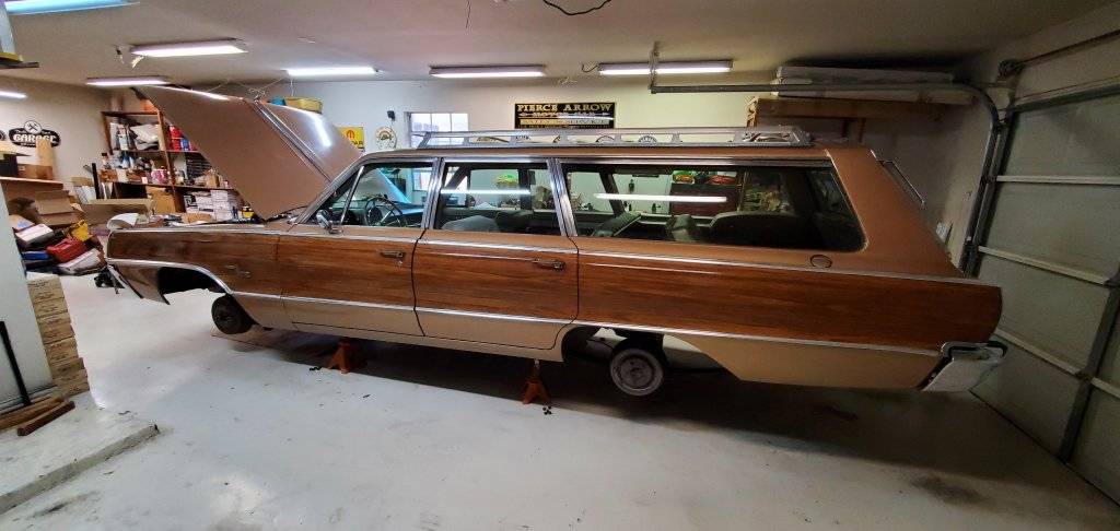

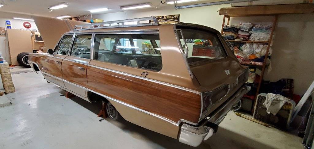

We are finally getting a bit of improvement in the heat so I have jacked the car up again and the wheels are off. I'm going to get the wheels balanced, do the speedometer cable lube, finish brake adjustment including the emergency brake, and do a compression test. Also some cleaning and waxing if my energy level holds up. Forgive the super wide angle pictures, I was playing with my camera phone adjustments. It does make my garage look gigantic, which it is not.

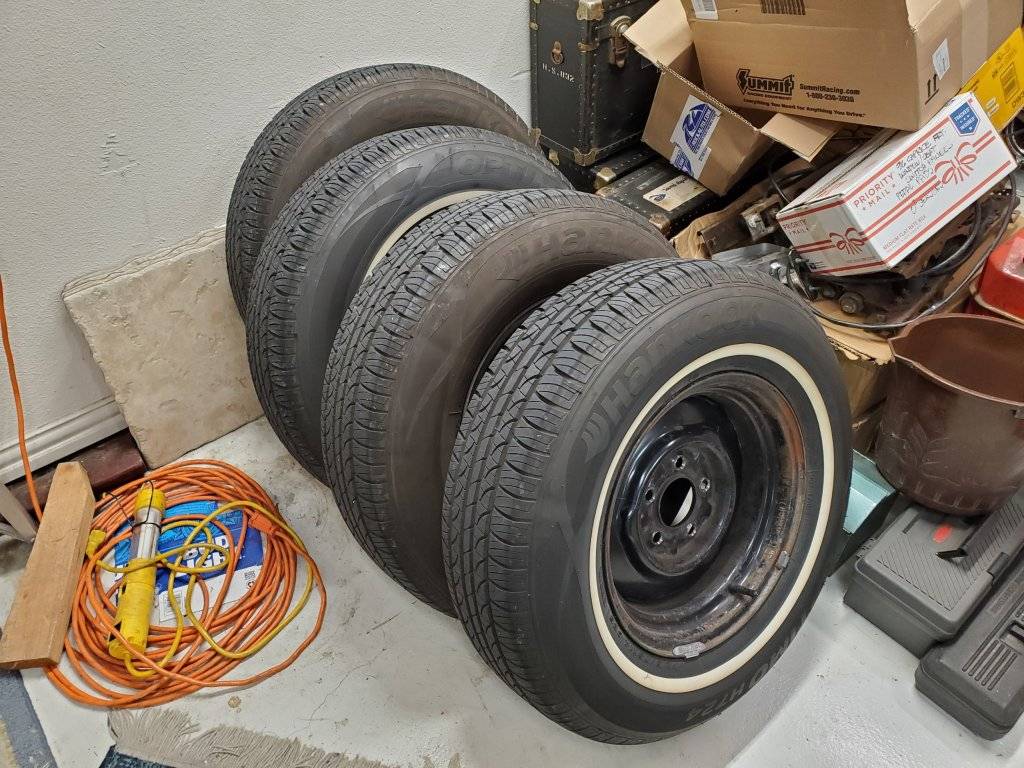

First on my list, I got the wheels balanced today. The tires are Hankook Optimos about 7 years old, I considered replacing but they have great even tread and no sign of damage. I was getting some vibration at 65-70 mph so hope the balance will correct. For most old car tire service I use Thomason Tire in the old downtown area of McKinney, TX where I live. Most of their business is truck and agricultural along with golf carts and fork lifts but they service cars also. They do mounting, dismounting. balancing etc. without looking at tire age or condition, as you know that is no longer possible at the large chain tire stores. If you live in my neck of the woods check them out, see link below.
Thomason Tire | Tire Service & Auto Service | McKinney, TX
I was pleasantly surprised to see very minimal weight added to all four tires, they removed a lot more old weights than they replaced. Hopefully that is good, I will see when they are back on.

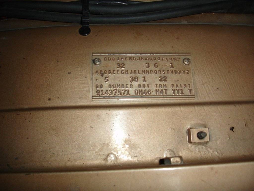

A little sidestep here - I thought I had done this before but apparently not. Can anyone tell me what my paint and interior color names are based on the fender tag?

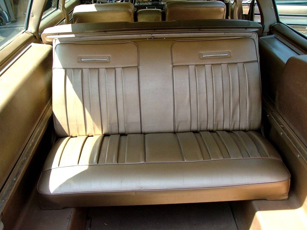

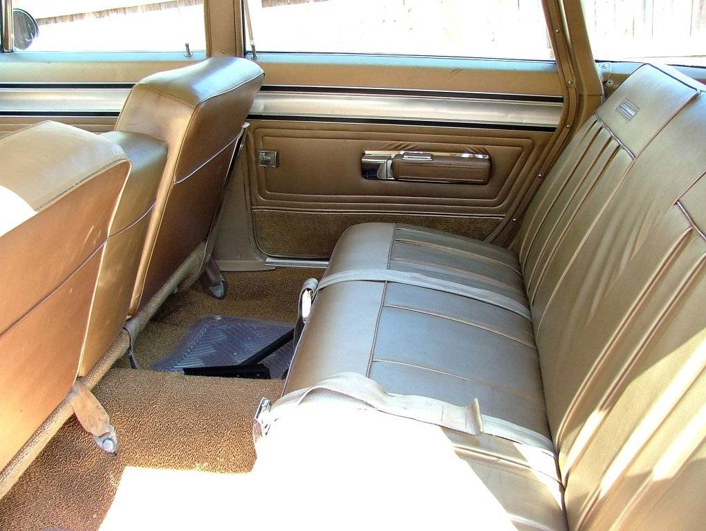

Today I finished the last two list items on this car. Winter has arrived even here in Texas and I was glad my antique garage heater still works. I gave the interior a complete vacuuming and wipedown. The seats are a combination of original and replacement vinyl, the original is a bit baked due to the southwest origin of this car but not too bad, the replacement is probably closer to the original color but looks brighter due to the wear of the original. The carpeting and windlace was all replaced by the previous owner and while I was vacuuming I noticed the carpet really looks excellent. It is a molded set and the fit is great compared to many past replacements I've seen.
