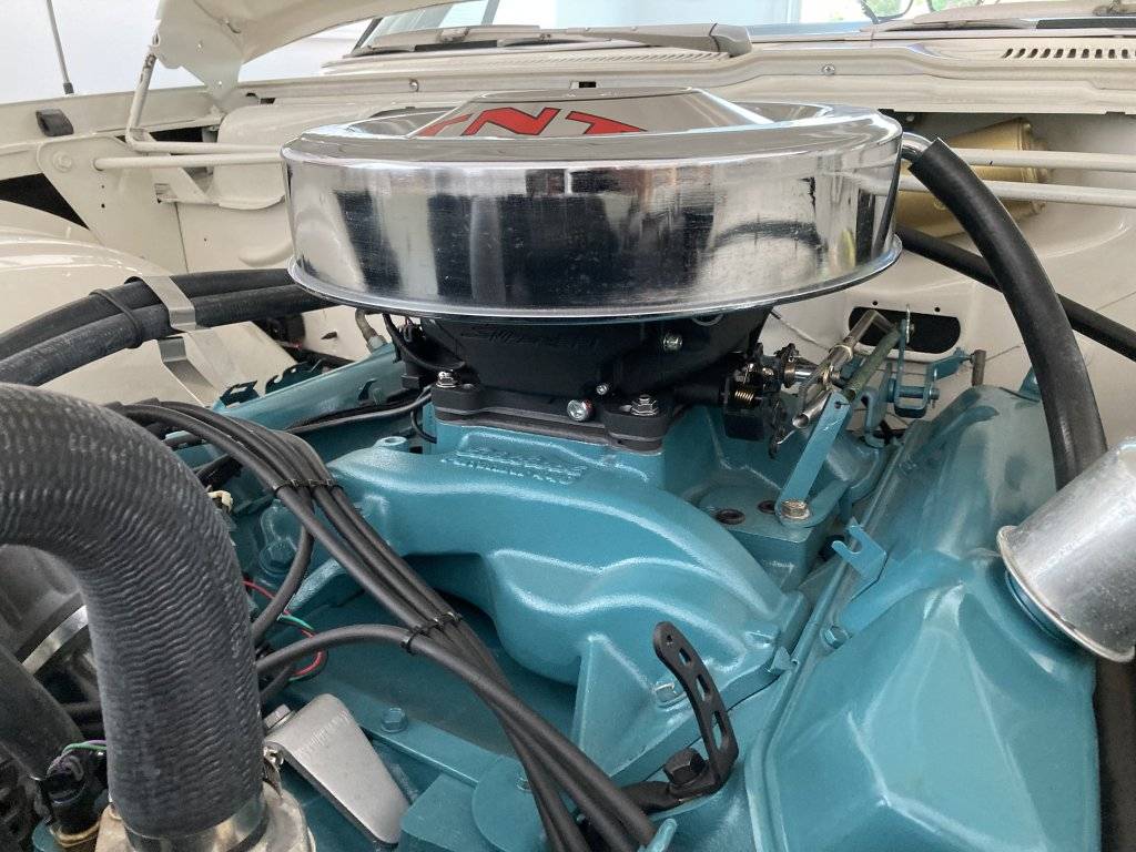

I have data logs of before and after the spacer, so I can check the temperatures and get back to you. Give me a day or two. (BTW this is a nice feature of the Sniper: you can log hot/cold start, idle, accel, cruise, etc. data to include temps, timing, RPM, throttle position, vacuum, and so on.)

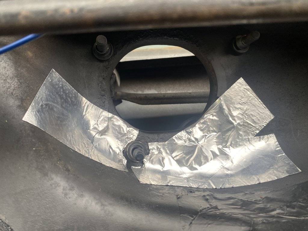

I was also having an issue with the fuel tank being very pressurized at the end of a drive. It may be a vent issue, but I also think it was hot fuel being sent back to the tank (the Sniper has a return line for the unused fuel). I have noticed a significant decrease in fuel tank pressure despite unseasonably warm weather here in VA, so I think the fuel is staying cooler (fuel being injected into the motor to burn as well as the fuel going back to the tank) but have no data to prove my theory.

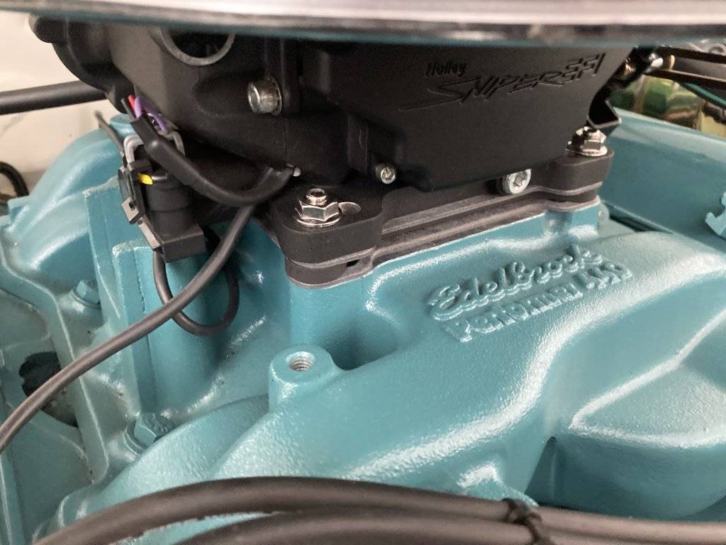

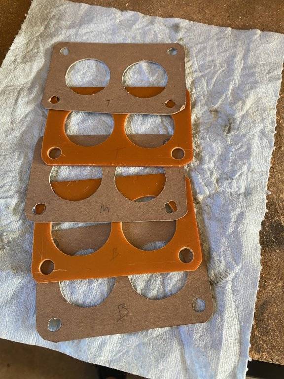

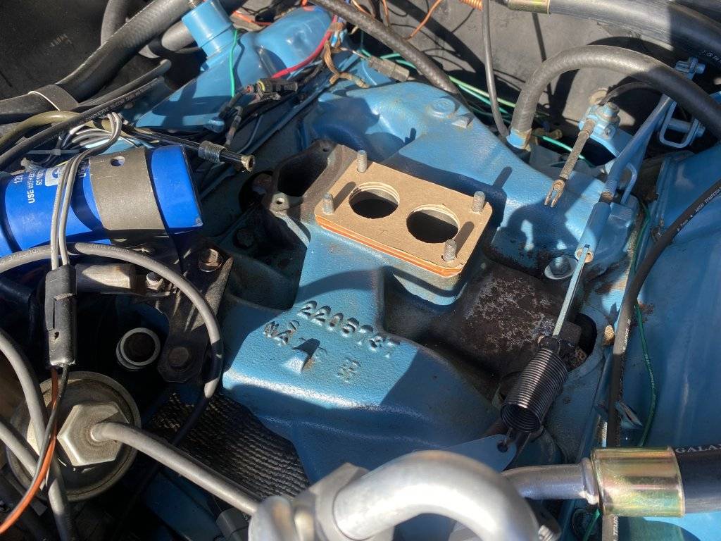

As a side note, I tried both a 4-hole spacer and an open spacer. My intake is an Edelbrock Performer dual plane, and I feel like the drivability and throttle response is better with the open spacer compared to the 4-hole. You might consider cutting out the center of one of your spacers to make it an open hole that combines both barrels on the intake and carb and see what that does to drivability and throttle response to your engine.
