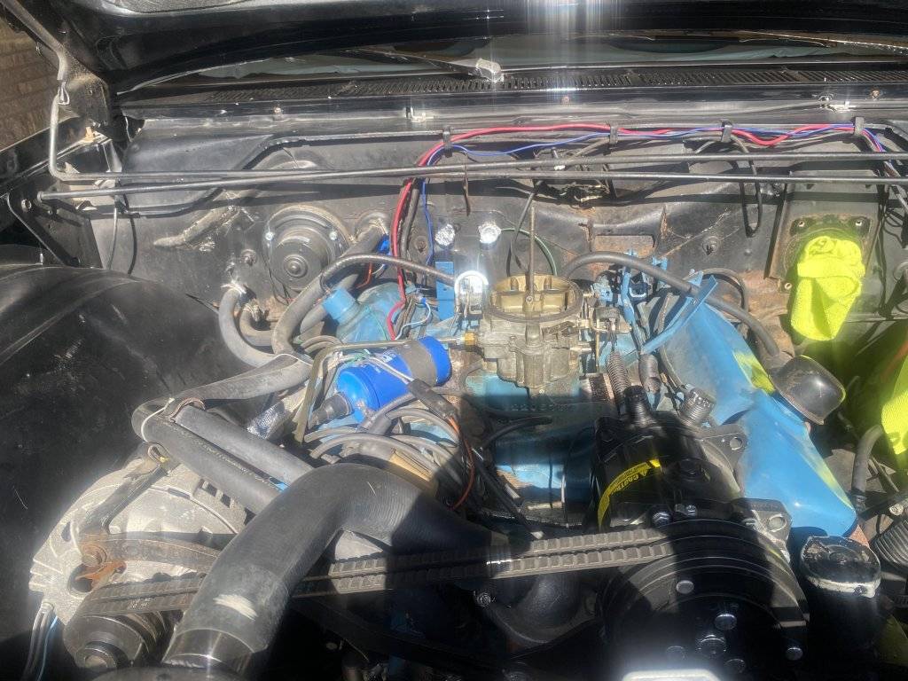

Yes, the engine was rebuilt at some point in the last 15 years or so, and they painted it corporate blue :-( I’ll redo it in the proper turquoise if/when I have a reason to pull the engine. Or if I get through my todo list, I could just paint the intake, valve covers and water pump housing and call it good, since that’s all you can see anyway.Your engine looks like it's light blue on my screen. From the factory it was turquoise. Thought I'd bring this up if your detailing involves engine paint.

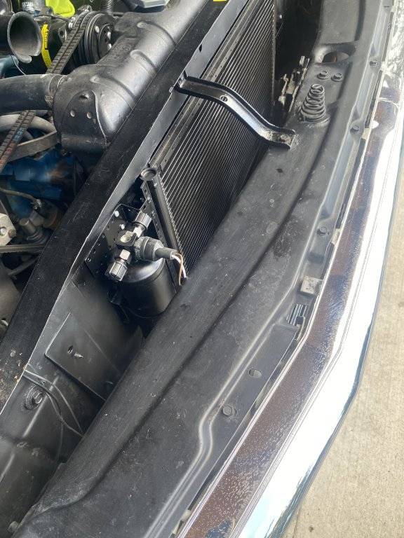

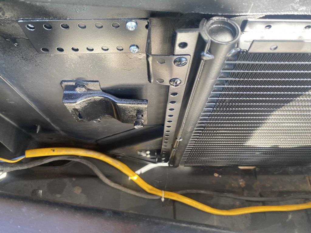

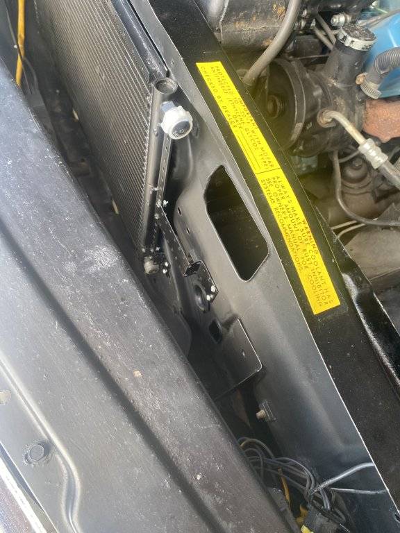

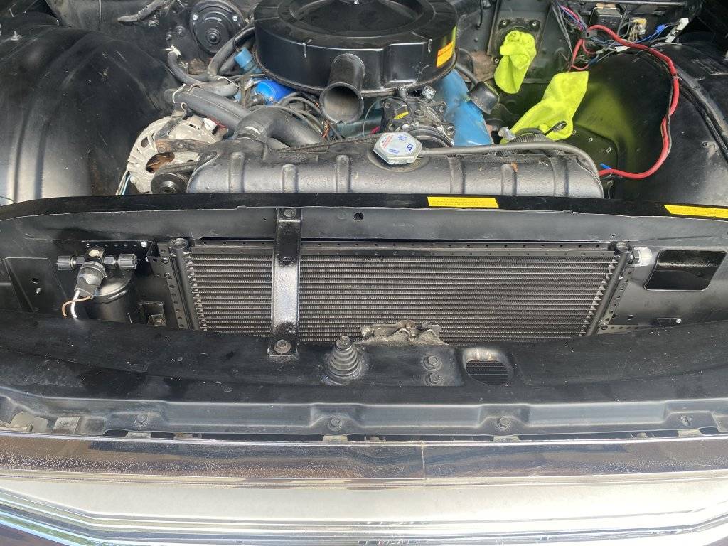

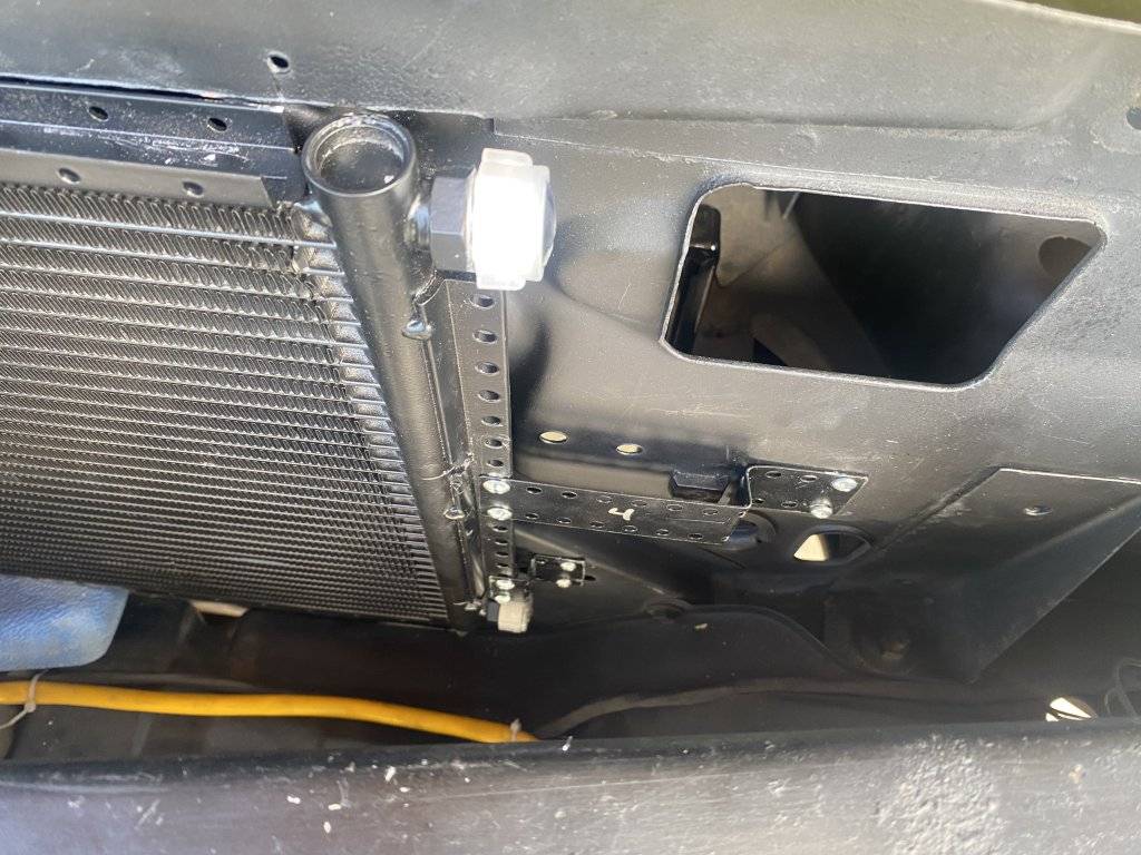

It’s aLooks great. I suggest that you try to source a shroud for that rad, now that you'll be putting extra cooling load on the system with the addition of the condenser.
It sure does, now that you mention it, but it does have a factory shroud. Probably explains why the 26” condenser was way too big. Somehow I had it in my mind that all AC cars had 26” rads.Interesting - looks like a 22" round top rad in your pics.
Measured just to be sure, and indeed it's a 22" round top radiator. It has the factory metal shroud and fan clutch. This car is a late '66 model, built in Delaware. Not sure why that would matter, but maybe they had a few of the '65 style heavy-duty rads lying around there that they needed to get rid of so they tossed it into my car. I don't know. The car shows no signs of any collision repair to my eye, unless the entire front clip was replaced, but that still doesn't really make sense that they'd use a '65 style radiator.From 66 and up, yes, AC cars got a 26" square top rad with plastic shroud and the appropriate sized rad yoke (bigger opening)... but a 65 rad with AC was a heavy duty 22" round top with a metal shroud. That rad would bolt into a 66 non-AC 22" rad yoke and look correct.
I believe there was a parts counter "high altitude and trailer tow cooling package" to fit the 22" rad (clutch fan and metal shroud), but they were sold/installed at the dealer, as any 66 ordered that way would have received the 26" inch rad, yoke and plastic shroud and clutch fan on the assembly line...
So all of this begs the question - if you say the car was originally factory air, but it has a 22" radiator and shroud/yoke etc. in it, then perhaps there was a front end collision which resulted in some of that stuff being changed out with '65 parts when it was repaired...
Regardless, if it's a heavy duty 22" and shroud etc., then you're good for the extra cooling load of AC.
