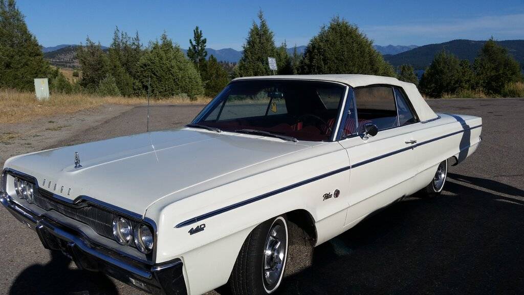

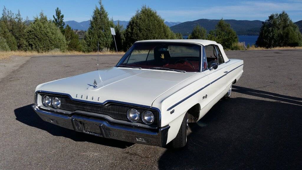

She's a Convertible 500 with a 440 and she's never left Big Sky Country. I inherited it from my uncle after he passed away. He loved this car and I want to take proper care of it in his stead.
