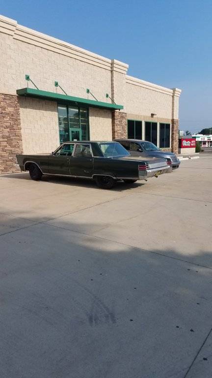

So im out with my car this mornin and the booster decided to to quit. Im actually at the parts store right now with the car lol and and we only see that you can rebuild the booster?? Didnt know if anybody is repoping anything yet that i dont know of. I saw a post on this but it was from a few years ago.

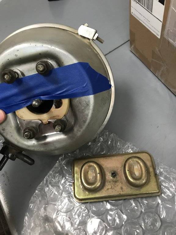

I sent my 68 booster to him should be back Monday. It was 3 weeks with the re-plating. I think he said about a week if you don’t want it plated. Sent the master cylinder cap in to replate with the booster for an extra $10 or $15.

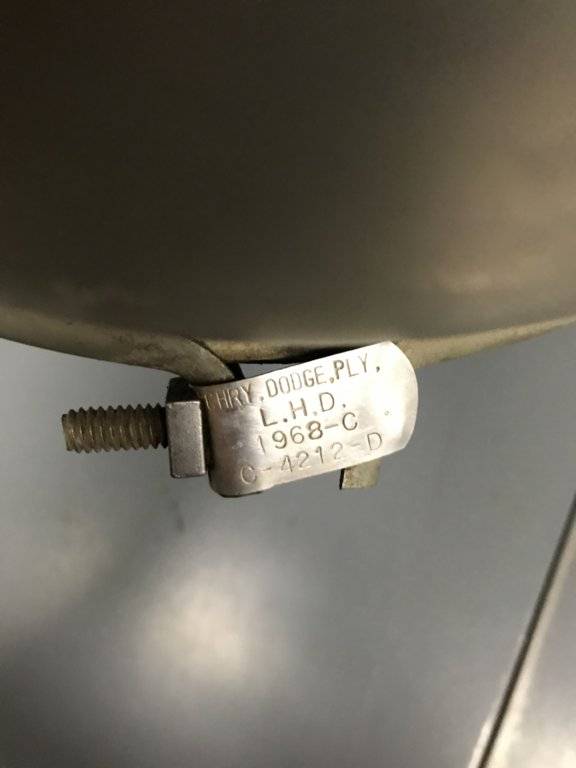

No I have drums all around so have the midland Ross band style. Yes cad plated. You are correct all the parts shop remains are gray. Before picture. Actually not too bad of shape, booster needed refreshing, so figured I would have it plated as well.
