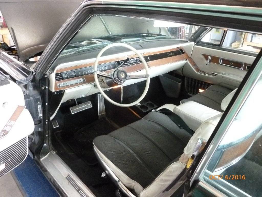

Yes, unfortunately the wheel has a couple of cracks. The wheel and interior are off-white, not silver. Also, the power windows don't work. I think the driver's side mechanism is stripped because it makes noise & I can pull the window up and down, but the other three don't do anything. My guess is that is has to do with the window lock switch because that's what they have in common?
I haven't lifted the back seat yet, so not sure about a build sheet.
Yes, for starters remove the master switch and all the others for that matter and clean and tighten all the contacts. Grease up all the moving parts on the tracks and refer to MrC's thread on power window motor repairs. If you can hear the motors working but don't get any movement up or down they can be fixed easy peasy.
Yep, I'd take the power vents over the ac any day.

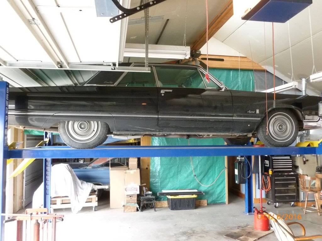

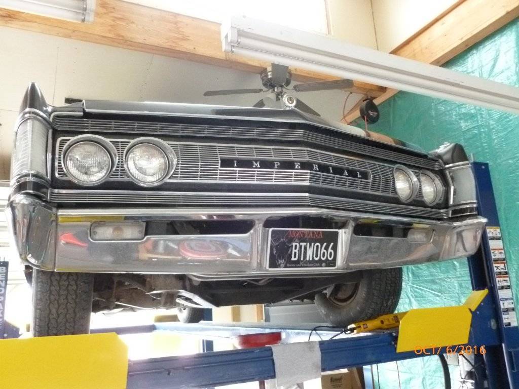

So how does it run and drive?
The cars runs and drives great! I put in a new set of plugs & changed the oil. This week I was hoping to get a new muffler, but it snowed today so maybe that'll wait until Spring. The tires are date-coded 1993 and are severely cracked, so a new set will be in order (also Spring).
