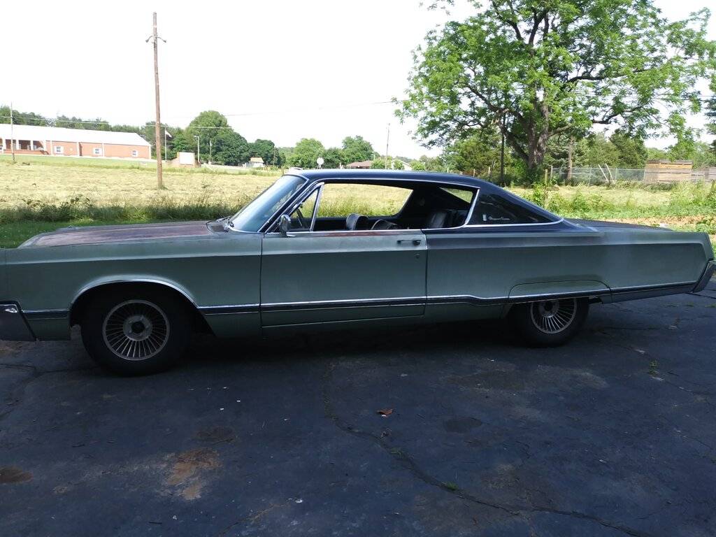

I have 4 brand new Hankook 225/70-15 tires on mismatched mopar rims.
I have 4 turbines that measure 8" outside to outside, I'm guessing 7.5 inside making it a 7.5 rim?
My options are to swap the brand new tires over to the turbines for $75 and run them or spend $600 on new tires in the 245/60-15 or 235/70-15

If it were my car I would swap the new tires onto the Turbine wheels.
Done.
Get the fat tires down the road once the car is completely sorted out.
Done.
that's what I'm leaning towards...I don't really have the money for new tires right now....and these are literally brand new minus a couple hundred miles. They are on road wheels of various years and one oddball steel aftermarket. no clue why. If they will fit these rims I dont see why I dont use them for now.
I ran 235 70 15 on my AAR cuda in the front. They fit the 15x7s fine. You’ll be okay. I did it for the sidewall. 60 didn’t fill the wheel well.
Just incase anyone wonders about that I did run 275 60 15 on the back. Wish I coulda found a taller tire w those 391’s Lol!!! Go for it!!!

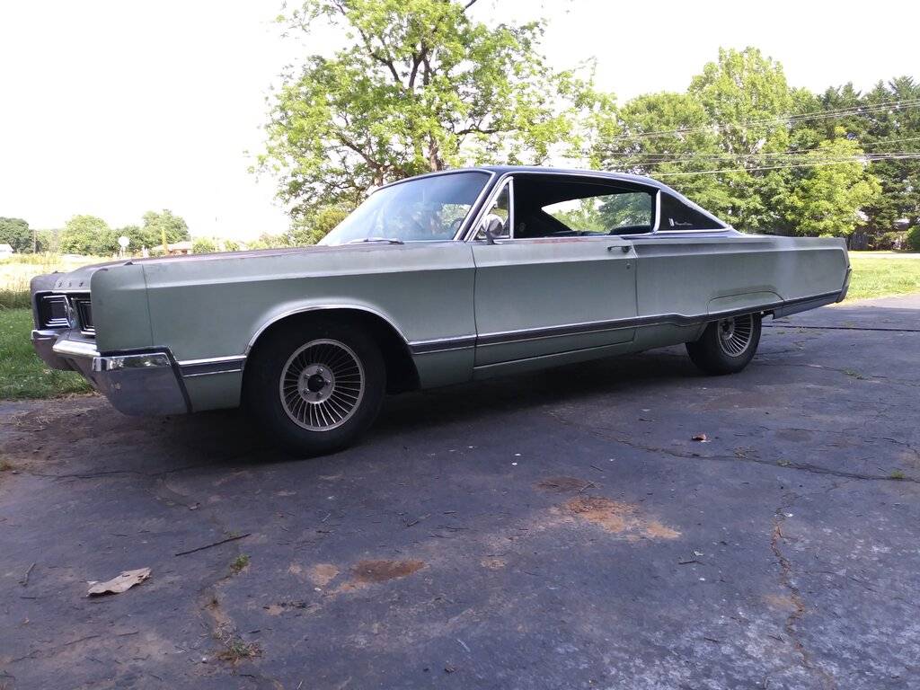

I went with the new tires I had for now...might as well use them and worry about tires later. They do fill out the wheel arches better...
