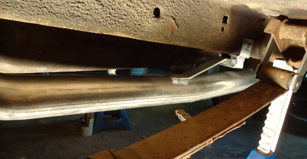

I notched the seam of the tank to get one bolt in!For me, this hanger was the hardest one to drill for. Fuel tank on one side and shackle on the other.

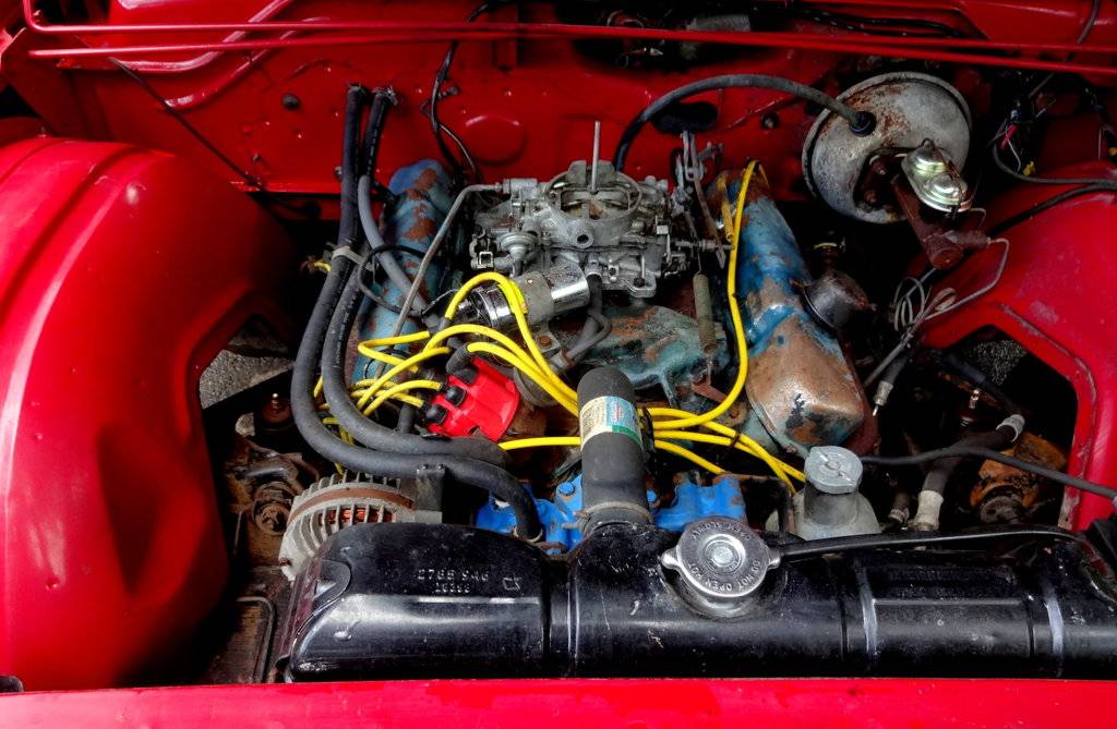

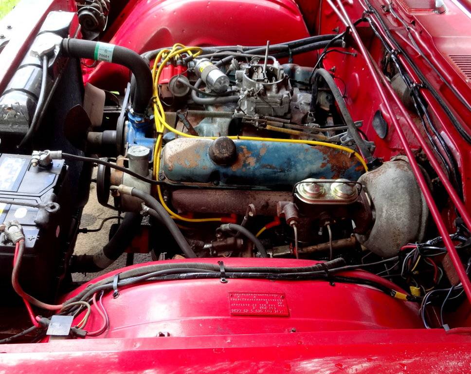

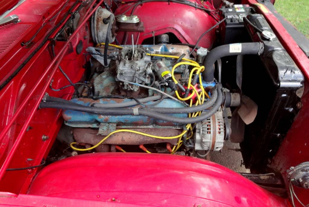

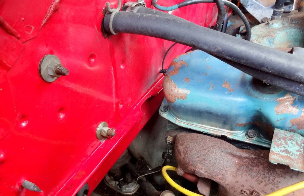

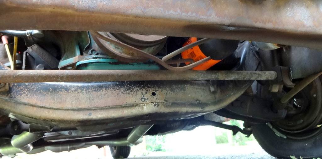

I did some power washing and exterior cleaning today. Engine bay and underbody cleaned up nice. I think I'll refinish the brackets and pulleys as well as the ford blue front cover. I'm not sure why the front cover was removed but there is an aluminum water pump installed. Will also install a Mopar tan dist cap, new ign wires, and a black coil. A through washing with Dawn dish detergent removed a lot of the oxidation from the paint. Big improvement. (note the hose).
