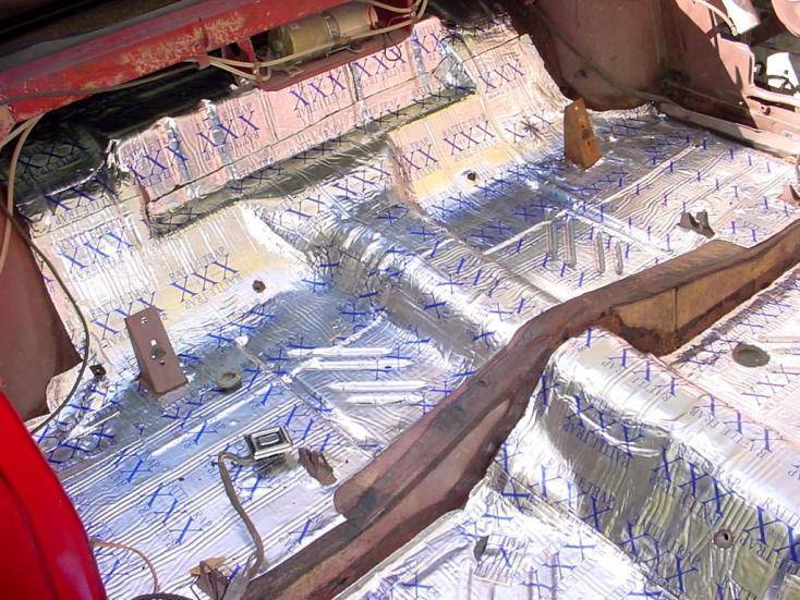

Installing sound deadner on the floor under the carper will make a big difference too. 50 sq ft of "Fat Mat", found on ebay for around $100.00 including shipping will do the job.
