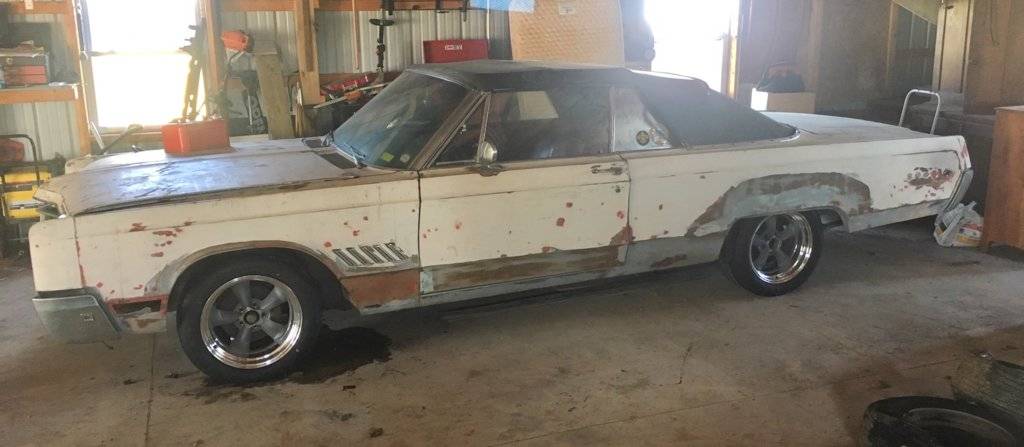

Nice looking ride and my favorite year, but I am a little partial LOL !
Gorgeous car! Side markers were standard on ‘68s.

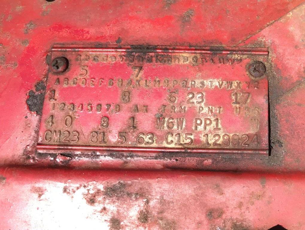

Post up a pic of the interior and the fender tag.

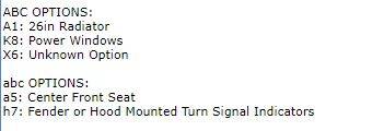

Seems to be pretty basic. I am still sorting out the build. The online tool leaves a few things blank.
Thanks for breaking this down. You did much better than I.You just have to make sure you get the letters and numbers lined up correctly - for most of them anyway. Always have trouble with the tire code.
CAR: Chrysler 300 2 Door Hardtop
ENGINE: 440cid 4-bbl V8
TRANSMISSION: 3-Speed Automatic
TIRES: Unknown tire code
MODEL YEAR: 1968
BUILD DATE: December 15.
AXLE: 2.76 Rear Axle Ratio
INTERIOR: , Vinyl Bucket Seats. White on Black Interior.
PAINT: Red (Dodge), Matador Red (Plymouth), Scorch Red (Chrysler), Flame (Imperial).
OTHER:
MOLDINGS:
14: Sill Mouldings
30: Body Belt Mouldings
78: Wheel Lip Mouldings
ABC OPTIONS:
A1: 26in Radiator
J8: Remote Trunk Release
P6: Rear Seat Speaker
R2: Music Master AM Radio
S3: Autotemp Air Conditioning
X1: Tinted Glass (all)
Y7: White Vinyl Top
abc OPTIONS:
h7: Fender or Hood Mounted Turn Signal Indicators

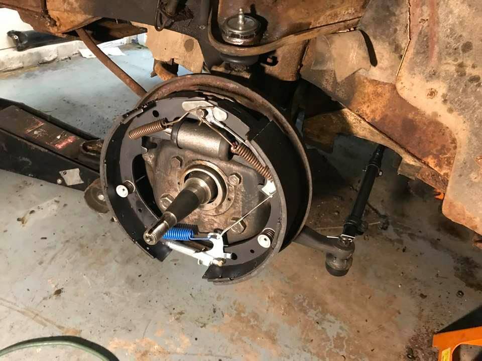

I am putting stock Gabriel shocks on it. I am trying to keep it as bone stock as possible.Are you sure you want to use air shocks on this beauty?
Thanks for the heads up!NOTE TO D RAY'S ALLEN ..SELF, Re-use original locking collar with the new sealing gasket when installing new sending unit .. 'Cuz re-pops are crap and WILL NOT SEAL .. My wordz of wisdom for the day. Nice '68 300 Slabby BTW. Love the azz end of those '68 300s, Jer
Brakes, ball joints, shocks, tie rod ends almost done and it is tire time.
Currently the 300 has brand new, 30 year old G-7014 tires on it. I have been looking at comps and came up with 235 70 R 14, 225 70 R 14, 225 60 R 14, etc...
What are you guys running?
Thanks guys! I should have noted that this car has the OEM hub caps and steel '14 wheels w drum brakes. I am planning to keep the caps, etc. I am keeping this car as close to original as I can.
