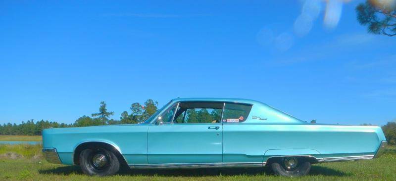

Out of curiosity, how did you get the magnums to fit with the Budd discs?
To refresh my memory, that conversion just requires a spindle and master cylinder change, right?They are on temporarily. I used a stack of washers and it's going to a friend tonight for a front end replacement project. It's being converted to '73 C body discs at the same time.
Those are the exact whee'ls I'd like to put on my '66. What are they?I was born abnormal.
Original 14's. No need for every newbie to make their first post with, "What's the biggest....".
Spindle and lower ball joints. It al ready has a disc brake master and booster and they're OK, at least for now.To refresh my memory, that conversion just requires a spindle and master cylinder change, right?
15x7 Chrome Magnum 500's from Summit as well as the correct wheel centers, also from Summit.Those are the exact whee'ls I'd like to put on my '66. What are they?
