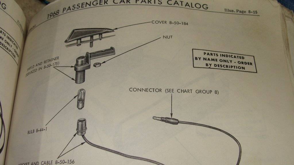

Hi, Sounds stupid, how do I replace the bulb on 68 Chrysler front fender directional light, I don't want to break anything. I appreciate the help
The socket simply pressed into the barrel.
The lip at the bottom is the socket portion
Use pentrating fluid and slowly twist and pull the socket out.
Or use a small flat screwdriver to pry thrm apart.
Careful not to squash the barrel!
Clean all mounting surfaces on the lamp and febder for good ground.
Hope this helps.

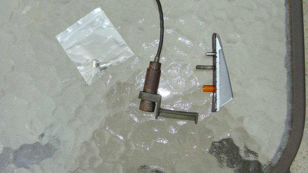

thank-you, that's what I thought but it didn't turn so I didn't want to force it, more Kroil oil
