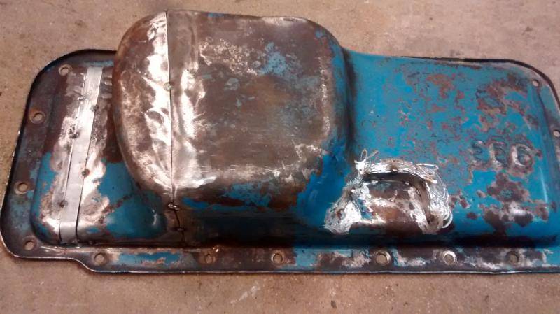

My Frankenstein oil pan

Fits fine and clears the idler arm now. Next I will put the baffle in and tig weld all pieces together.
Also had a chance to tack the sway bar mounts in place.

Nice job. Way to think outside the box, or pan in this case.

P.O. put some aftermarket deep oil pan on and my steering idler arm hits it when making a tight right turn.
can you weld an oil pan? like if i carried mine to some shop, could they cut it to make a notch for the idler arm travel fit and weld it back together?

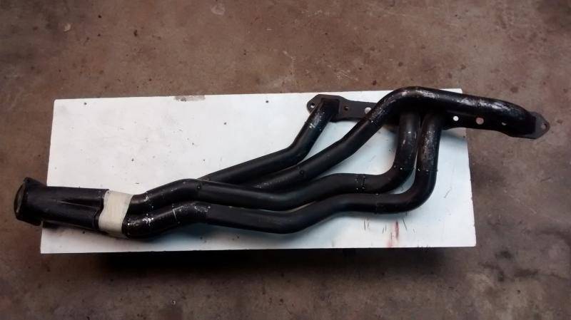

Yesterday was a headers-day.
Tacked the right side header together. As I have learned - it is a complicate job to make it fit nicely. I looked at different options, TTI headers and I did not like the way the headers are configured on the bottom - they exit close to the engine/transmission and go under the torsion bars - which makes them stick out waay to low. I decided to route the headers between the stub frame rail and the torsion bar so it exits at the right spot and goes straight to the cutout in the back of the frame. With this setup I have about 1/2" clearance on every side of the header - is it going to be enough? I am afraid the header might touch either frame or torsion bar when the engine is vibrating - what do you folks think??
