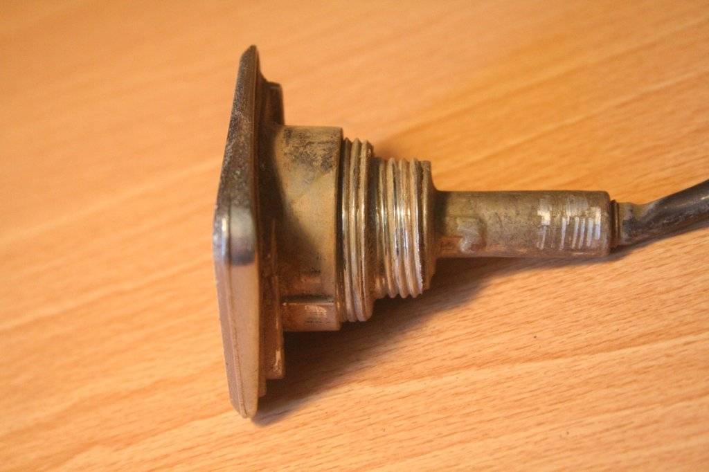

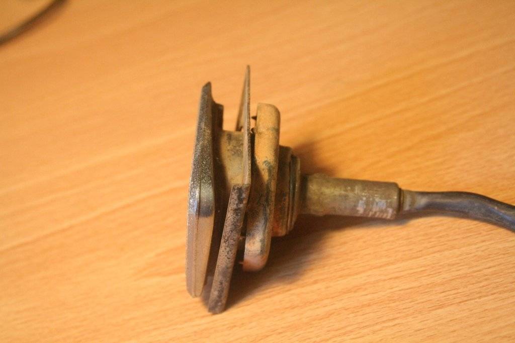

This marker light is a front one, notice that the bezel that is visible on the bumper is tapered. Check which way the bezel goes before removing from the car. It's narrow towards the top.

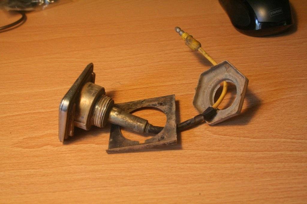

This pictures shows the sheet metal nut unscrewed and the shim that goes on before it.

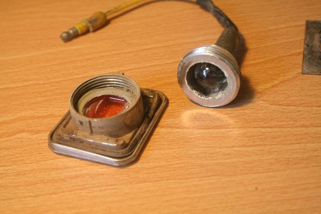

In this picture I've started to unscrew the bulb holder. The larger set of threads. Getting the holder to break loose can be a bit of a pain. This one actually cam loose easily, just be patient.

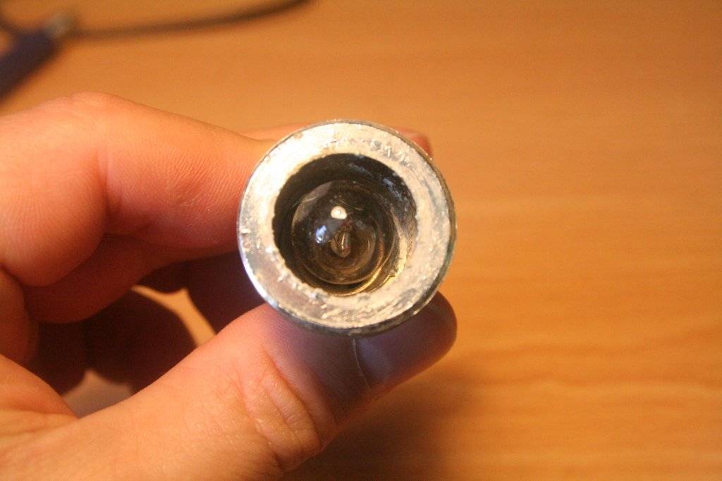

The bulb holder is completely unscrewed. I bit crusty too. This ones a spare from a long gone car. Inside the bezel is a thin gray gasket.
Here's a shot of the bulb holder. I would certainly clean this up a bunch if I was going to try to use it.
