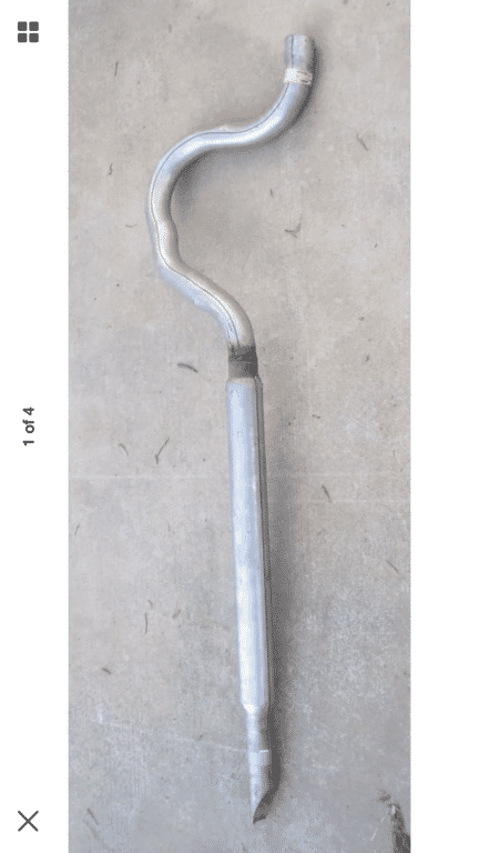

I have a tail pipe with resonator on it’s way.
Not 100% necessary, but will be cool to have an original. Besides I want to see how this is made.
Yes, I decided to stay with single exhaust.
Any suggestions for a original sounding and looking muffler?

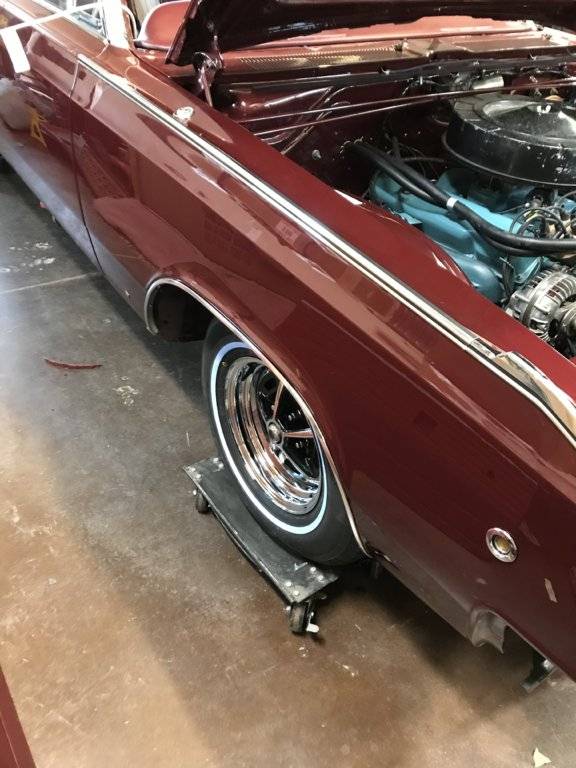

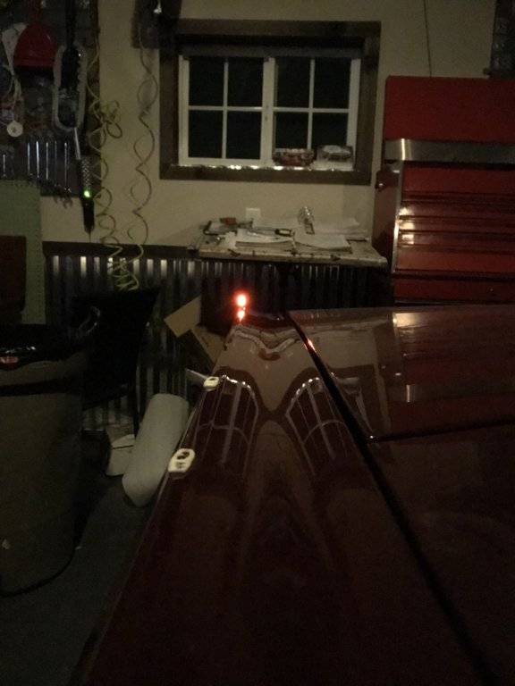

Fender tip turn signal indicators fixed and installed. I think I had an earlier post that showed my amber lights in pieces after trying to get the cap unscrewed to get to the bulb. I clear epoxied them back together and polished.

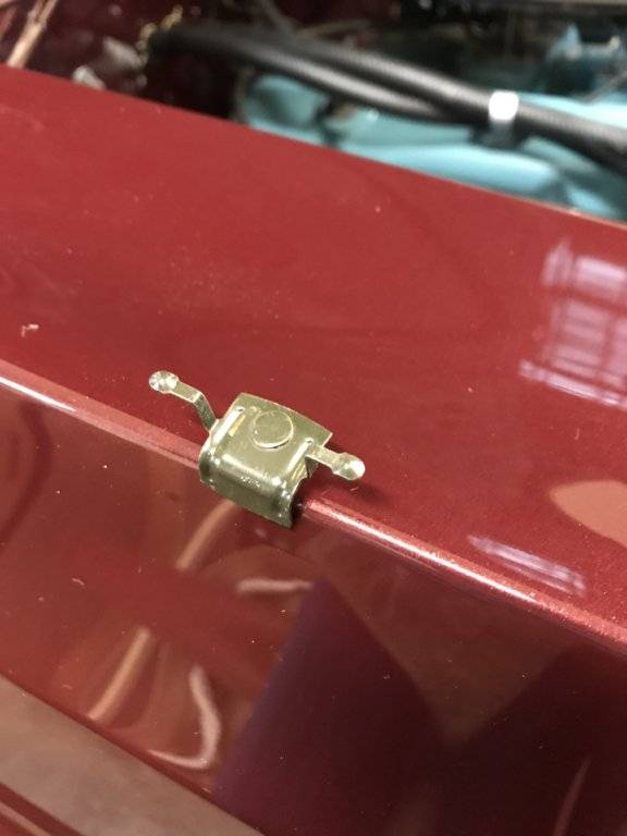

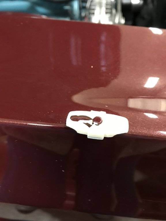

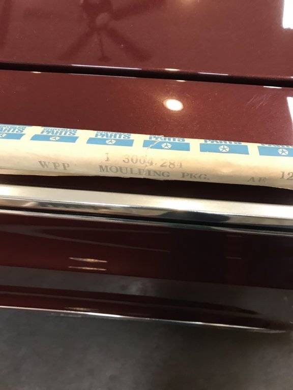

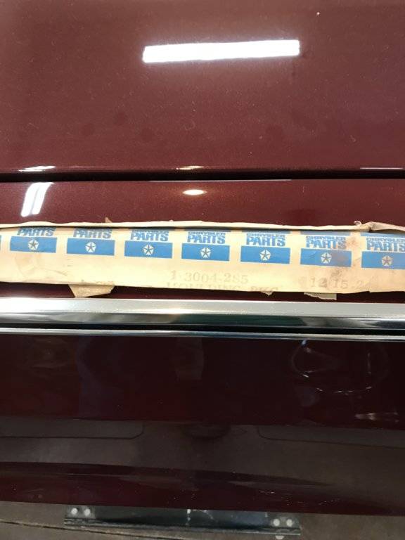

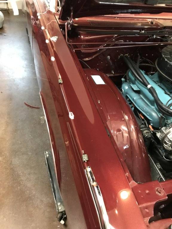

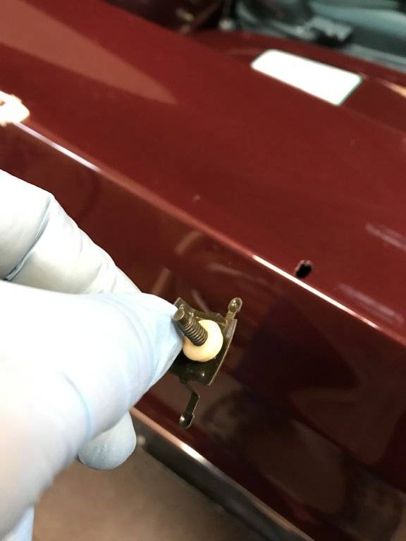

Decided to put my front beltline moulding back on. I found 2- Nos pieces as my right front was crunched and the left was very scratched up from years of leaning over the hood. Shots of the clips for future reference.
My other pieces buffed up pretty good and are straight , but I won’t be able to get the scratches out unless I take the anodizing off and sand out. For now I am going to concentrate on finishing the seats. The scratches can wait and don’t affect drivability. That will have to wait till the end. My goal is to find someone capable of anodizing 8’ long pieces.

Interesting to see that the same plastic clips are used on 72-73 Imperials to attach the trim around the vinyl top.
The plastic or the metal clips? Or both?
I have been looking for a source of the little plastic ones. They have little obscure tabs on them to keep the trim from riding on the paint. I found some that were close, didn’t have the side protection. At least my NOS pieces came with new clips, so I may have enough plastic ones to go around.

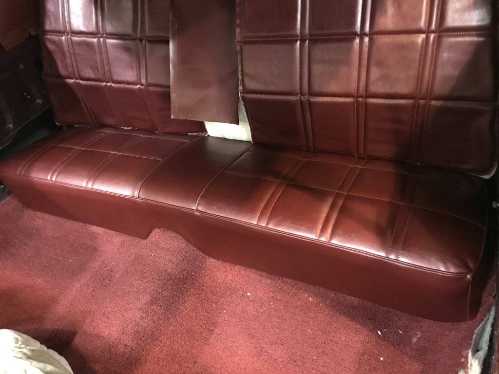

Here I go back to the seats. Maybe I can get the rear bench close to finished.
Rear bench finished. Details on my seat build thread. Rear back next.
