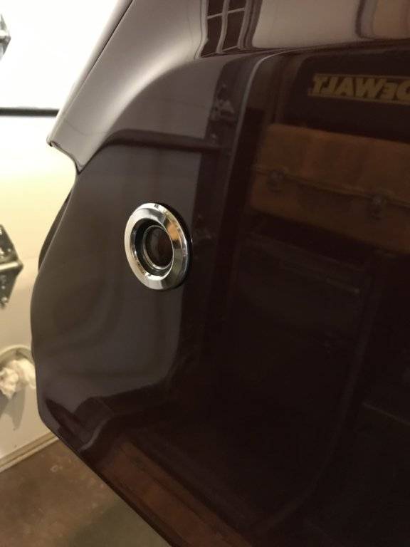

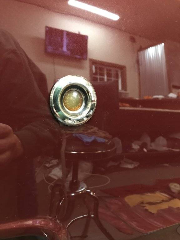

Detailed and installed my side marker lights. The rears were a little more difficult as the lenses don’t easily come out, so had to tape the lenses before painting the black and had to be careful with the wipe.

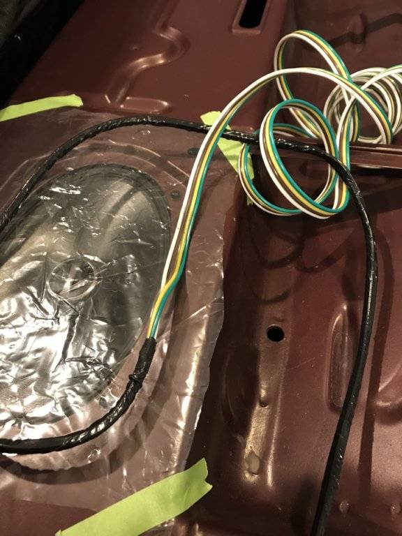

Wrapped and ran my rear speaker wires. I used the vinyl friction tape, so it looked like it belongs. I used trailer light wiring. 16 gauge, 4 wires bonded together.

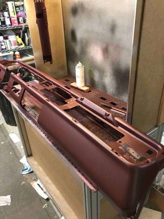

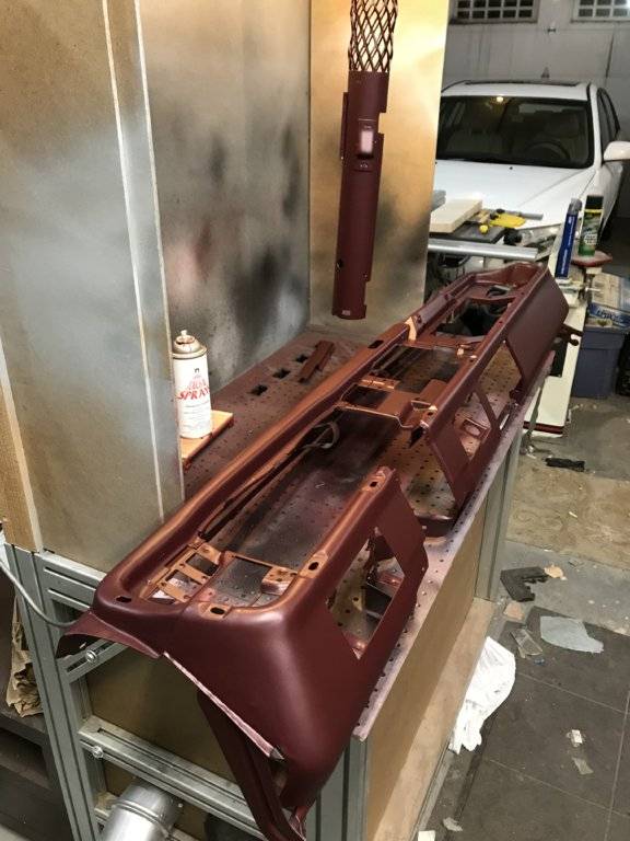

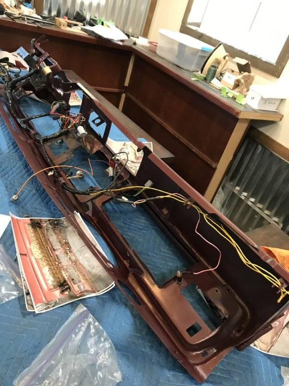

I couldn’t deal with my dash not quite being the right color and texture so I ordered some paint from 47784paint1. Chas mixed up the proper Aztec Maroon Metallic Suede. I sprayed it on and it now has the right color, look and the rougher texture that I remember.

View attachment 237380 View attachment 237381
That ``Suede`` caught my eyes. Which brand makes them nowadays? BTW, I have to again say that the part looks good!
The shop that did my paint said they couldn’t spray the suede through their guns.
This was a special mix that he has refined to match and put in spray cans from 47784paint1. He told me what brand he used, but I cannot recall right now. (Maybe PPG). Not the cheapest in the world at $65 for two cans ($15 was shipping), but I think I got my money’s worth. He will also mix up pints or quarts.
Not sure if he can ship to Europe though. Or if he would reveal his recipe.
He was very helpful over the phone and willing to work with my body guys if needed.

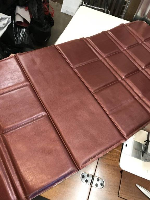

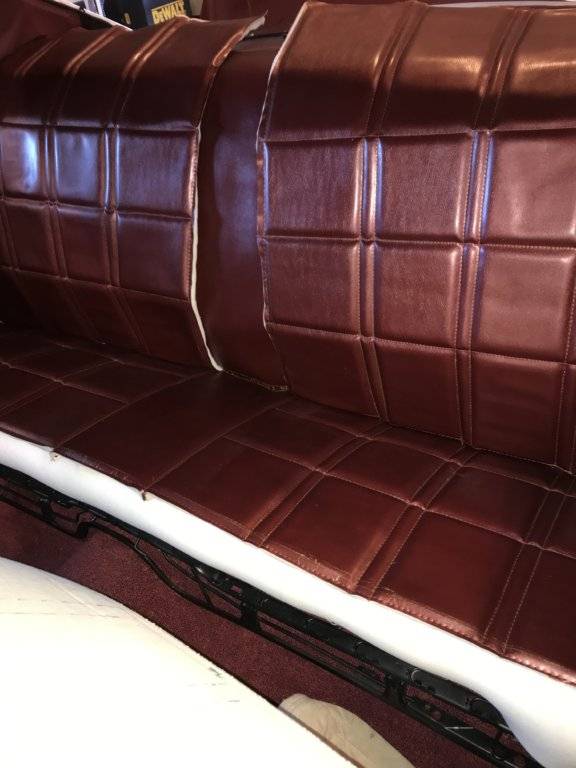

Rear seat cushions quilted and rear seat bench inserts are sewn together. I am going to complete my rear seats before starting on the front. Going from least visible to most visible. Rear bench, rear back, front back, and then front bench. By the time I get to the fronts I should have some of the tricks figured out. Link to the seat build below.

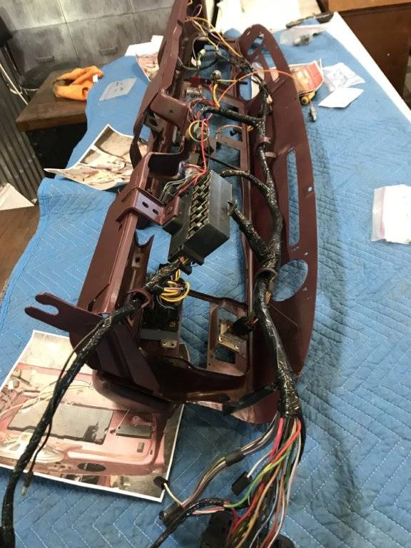

Dash frame wired. Switches in.

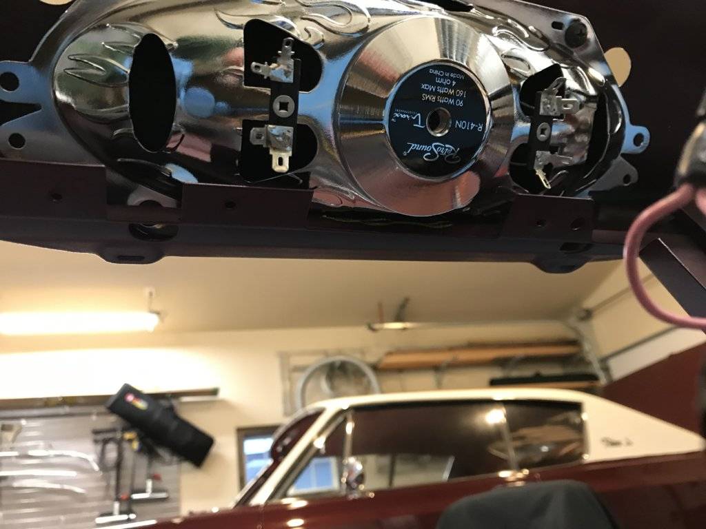

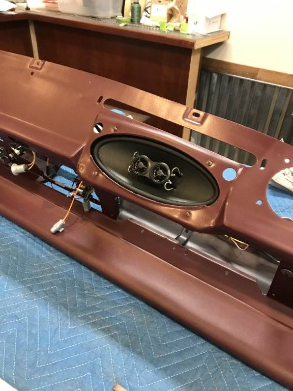

My low profile speaker was a little tight. I had to take a chisel to the top opening of the speaker to knock it down about 1/8” so it would fit. If they would have used a solid stamping instead of trying to make it cool by stamping flames in the surround it would fit.

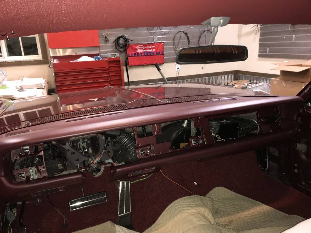

Dash frame and top pad in. Defrost vents connected. Tomorrow I may plug in the battery and double check my switches. Bulkhead connector in and connected.

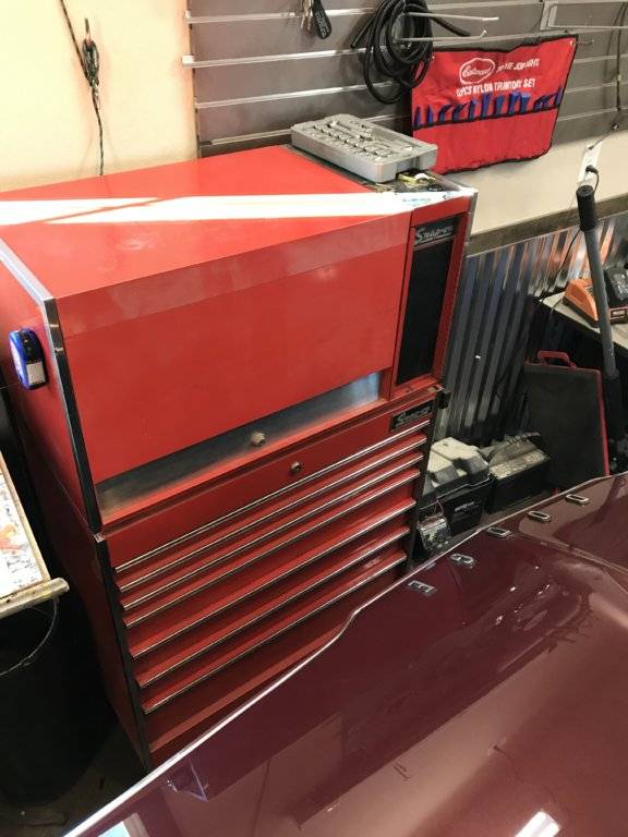

Looks great. I see your tool box in the background, do you have the matching lower to it? I have the same model Snap On box with a couple of small side boxes hanging on it.
Have top and bottom. I bought it used from the Snap-on guy in 1988. He let me pay a week at a time and threw in a new lid and locks. I thought that was a good deal when I was making $5 per hour. No side boxes though.
