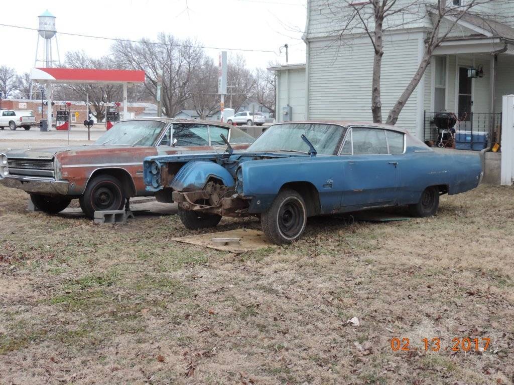

Took delivery 20 minutes ago. Will get some pics tomorrow. Not bad for a $450, a set of axles and a center section. If it's on the road in the next 10 years it will be because it being towed behind something, but we definitely just stepped into another level of car ownership around my house. I bet I don't sleep at all tonight. It's like that baby is under the christmas tree out there tonight. Yes!
Cool car and quite rare. I know a guy that has the same car in convertible form, same color too.

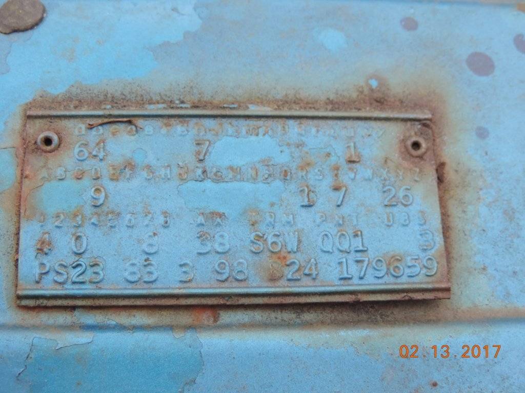

Anyone done any digging to find out production numbers for a 4 speed 1968 Sport Fury? I'm sure there were several built but I wonder how many were special ordered with an L Code 440 HP plus power disc brakes and a sure grip? Also no A/C. The current owner is dropping this off to the new owner (me) tonight and short of consulting Mr. Govier I would have to guess this is a low production option list. Be a whole lot cooler if the motor and trans were in the car but I don't think $300 would cover that. Thank in advance for any lead that might help.View attachment 114634

Ok, this tag tells me this is a '68 Sport Fury two door hardtop with a 440HP, 4 speed manual, 8.15-15 b/w 4ply police grade tires, bfd/spd Nov.24, day/night mirror, belt mouldings, a locking gas cap, 3.31 9.25" axle w/suregrip, black & white bucket seat interior, bright blue metallic paint (top & body), white stripes, pwr frt disc/rr drum brakes, a.M. 2watt radio, tach, tinted w/s, black v/roof, ctr console, fdr mtd t/sig lts and it was a sold car.

I can picture the guy who ordered this beauty sitting at the salesguys' desk and ticking off those boxes...
SG - yep
440 - yep
4 speed - yep
Buckets? - yep
What color? Blue of course!

I will certainly keep an eye out for that rear end - if any luck I'll just repost the 60. And thanks for the tag decode. I used one online too but they seem to be made to confuse people - seriously, can't it just have a space under each spot so you don't have to count your spaces to get it all lined up! Yeah, someone had it in mind to stand out among their peers with that order form option list. I couldn't sleep this morning and was thinking about what this car would look like tubbed..... If you are a purist like I thought I was, I understand if you hate that - but just imagine it:rolleyes:

It would be INORDINATELY unusual for there to be something stamped underneath every letter and every number on a fender tag. Everything represents something different plus if a particular digit called out something for which there were no options, it would be blank anyway.

I understand how the tag works and meant if there were a designated slot for each letter or number to be placed in instead of just having to space it all out to fit it would be easier to use. Anyway, I have never seen one with anything but stock tires and suspect it would have an incredible stance and ride height. Please don't shun me to the wilderness for my transgressions...
