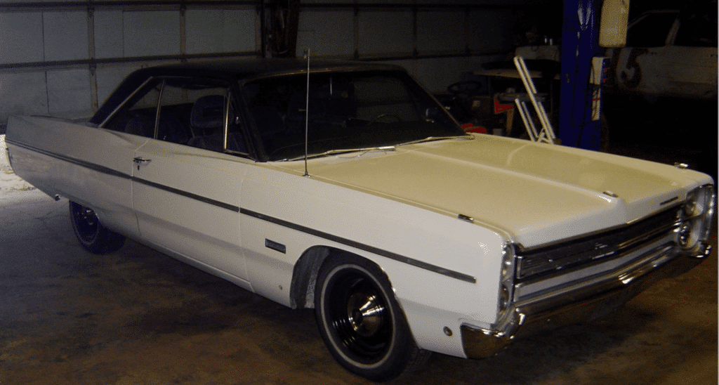

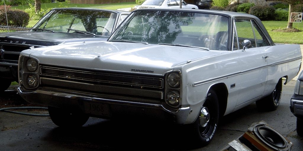

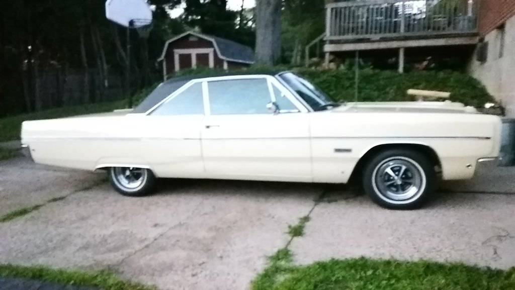

Firstly, it's either a SF or a Fury 3, not an SF III.
Due to teh side stripes and the SF badges on the fenders, it appears to be a SF with an F3 trunklid.
But - the column-shift is odd to see in a SF. The doorpanels are 'custom' so there's no clue there. And the red-white-blue emblem is missing from the grille, so maybe an F3 grille.
Regardless, in a C-body, stock or tasteful mods are what other people find acceptable. But it's your car, only you can decide if you want the car your way, or for other people's approval. The lucky few get it both ways.

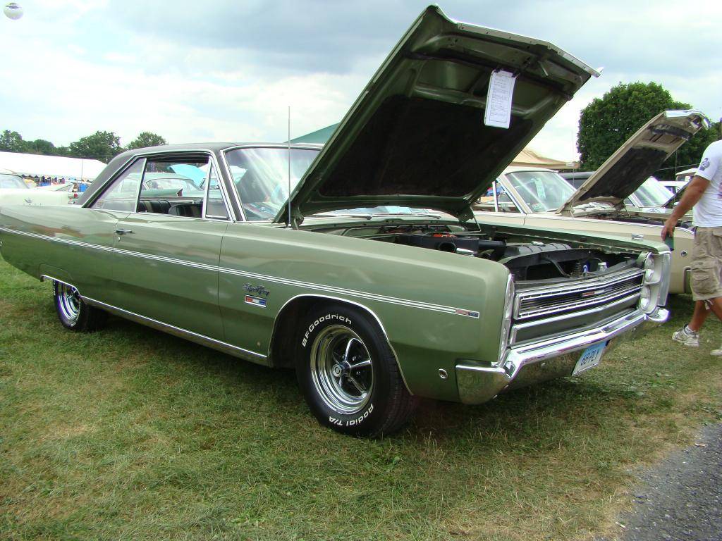

Stock with Magnum 500's for reference purposes

Do you think it was reupholstered? The fender tag calls out vinyl seats but they are vinyl/cloth seats.

The VIN should define whether Fury III or Sport Fury, I believe.

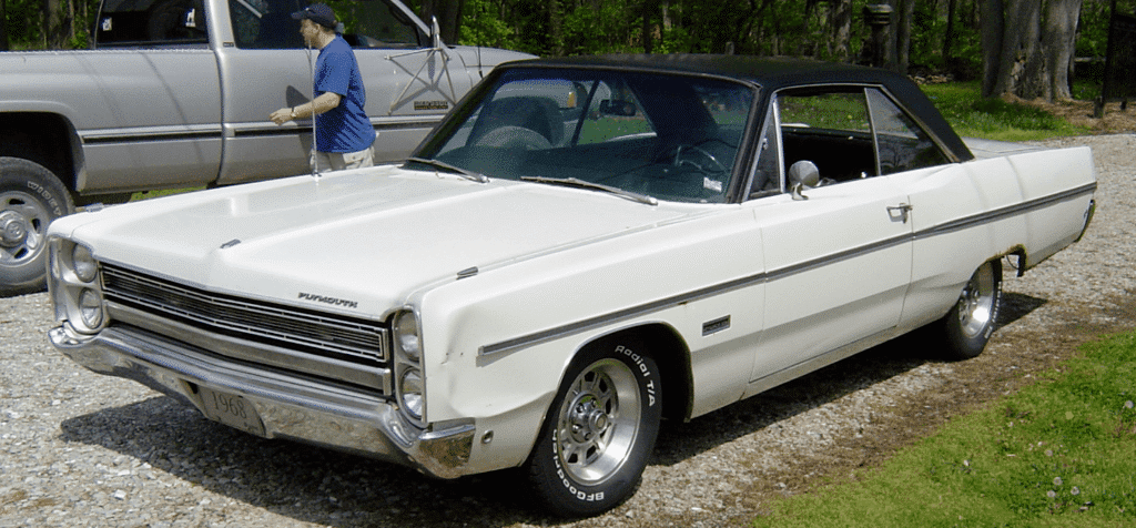

As your callname mentions 'budget', here's how mine has evolved over the years.
It came home in 97 wearing the same wheelcovers you showed in 1 of your pics. (all I have of that is some old 4x6 photos)
Looked much in this style but a white 2dr wearing bias-ply double-whitewalls.
2003 has new wheels/tires and the green vinyl top got a split so was peeled off and painted black.
2007 is mostly the same cosmetically but is now wearing a *fine* set of skinny whitewalls. (they matched, held air, and were free from a buddy).
And I patched some rust and got my fenderskirts back.
2009 got 7" rims up front, and 8" Ramcharger rims in back. The same buddy mentioned above scored some new 275-60-15 tires he sold me cheap, so I bought some 235 fronts to match. Disc brakes and a slightly-narrower B-body axle with re-located springs helped fit the tires behind the skirts without any rubbing. (skirts came off to get a bath that day)
