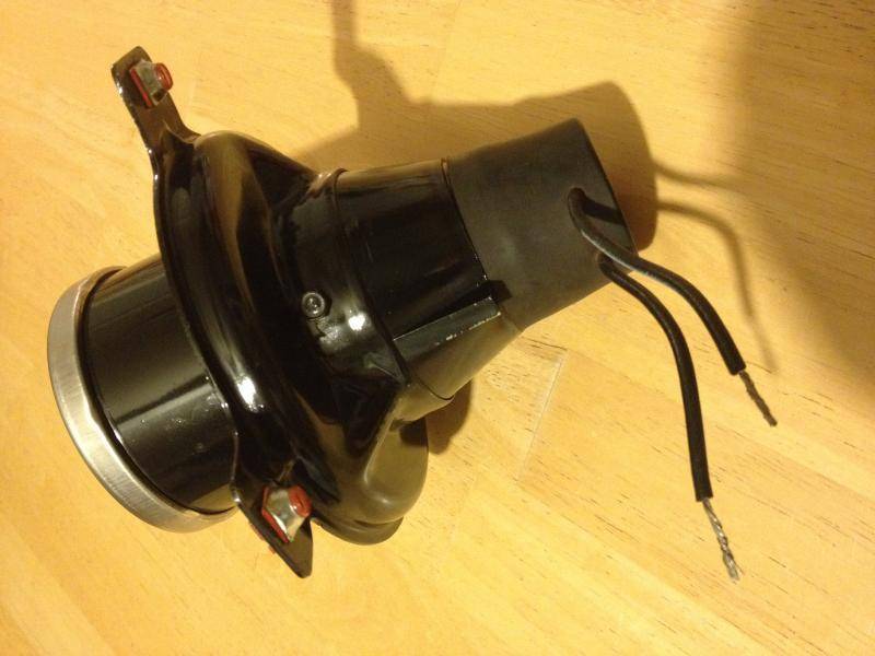

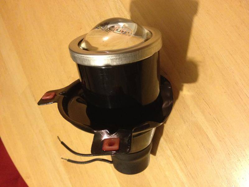

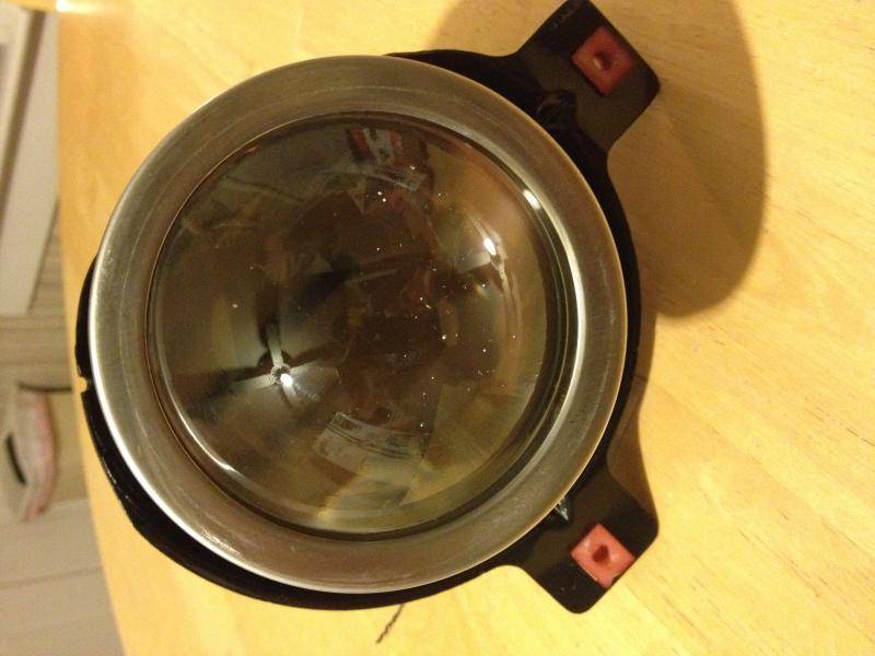

Yeah, it is in pristine condition and has never been installed by looking at the original plastic (red) mounting tabs. The lens looks like blown glass which is something that surprised me that they didn't use a regular headlight style lens. Pretty cool!
That's a nice one..... Look at that glass

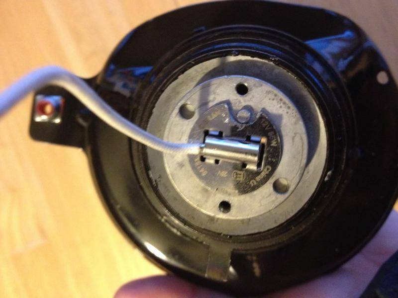

Sylvania H3 worked pretty good. I had to modify the bulb flange so it would fit the locator pin. And the bulb wire fits perfect in the original wiring connector. bulb3.jpg
