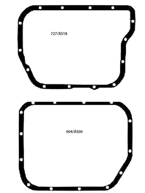

Almost every Australian built 318 car had a 727, check for yours by the image below.

I dont need to be brought up to speed thanks. I know the differences, but for the sake of being under the car and looking up, the image I have supplied is the quickest way to tell which is which.
