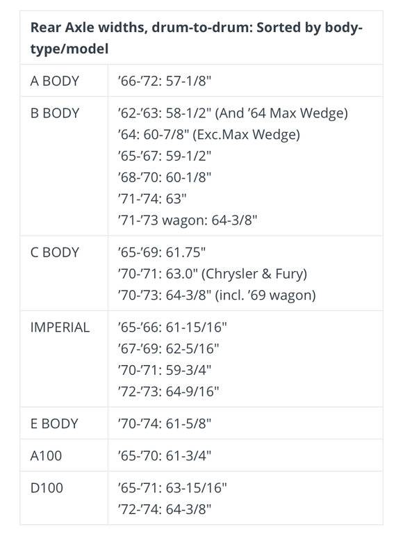

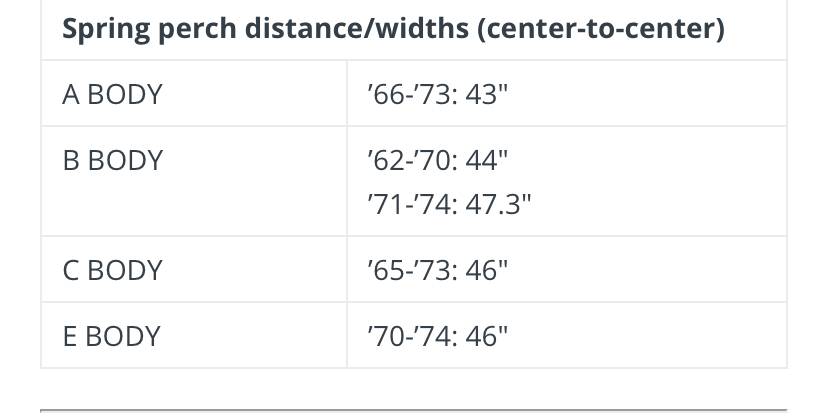

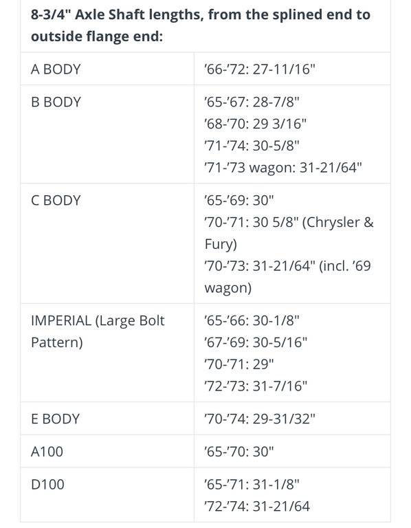

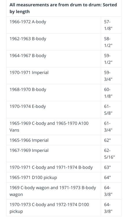

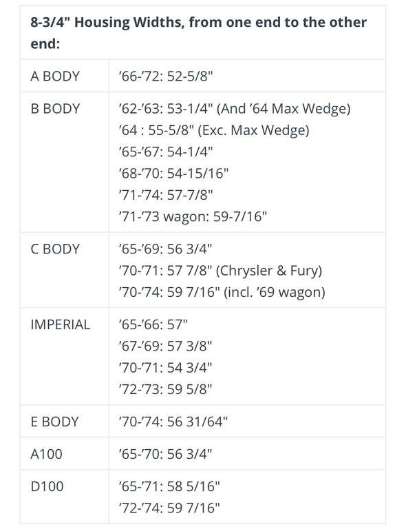

Here’s some measurements that may be of interest

From past memory the 65-66 had a wheel track of "Approximately" 60.00 Inches (Mostly 741 Centre's)
67-68 were "Approx" 1.5 Inches wider around 62.5 inches (741 & 742 Centres)
The 69-72 were again another 1.5 Inches wider. 64.00 inches (small number 742, Mostly 489 Centres)
All Centre's were 3.23 Ratio Open.
This seems to differ somewhat from the info I can find on American built Vehicles.
The only Explanation I can think of is that, as 1970cat suggested, the H/Top had an earlier model diff fitted to allow for the wider wheels.
Regards Tony.M
