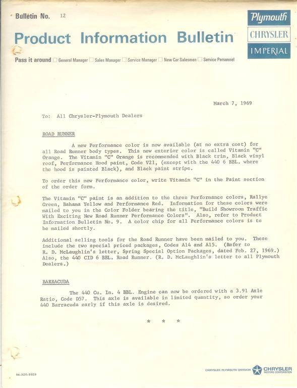

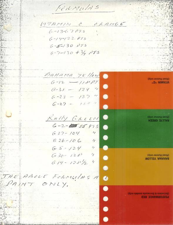

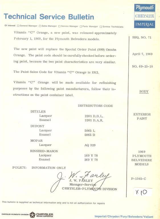

999 was the special order paint code used on all 69 b-bodys.... Not sure about C-bodys.
The actual color code appeared twice as a single digit and number on mono tones, two tones received a different 2nd code.
Omaha orange as used on 68 and early 69's was replaced on or about feb 1st 69 by V2, (hemi orange) on Dodge and EK2, (vitamin C) on the plymouth. They were different colors.
Attached are a TSB and a product information bulletin
Sure is a lot of twists and turns on the 999 special codes. Very interesting.
