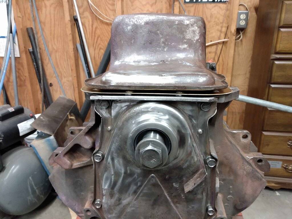

I used Milodon 32000 Windage tray on my 1969 440 and it was too tall for front of 187 pan. Need height of tray and depth of pan before wasting $. Mine Runs fine without tray or baffle. Will burn rubber with 3.23 sure grip.
