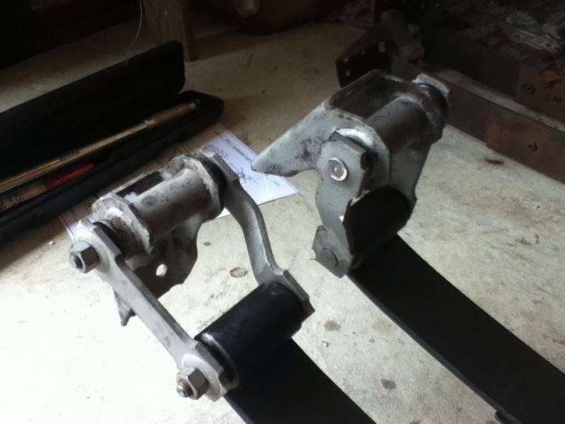

Take the old rear shackle hangers apart and look inside the hole where the shackle bushings are. You take out the two rubber bushings out and look in there and there is a third smaller bushing that spaces the two outer ones apart. Use that with your new shackle bushings.
It's probably not a big deal if you don't but I think it would be better to use it.

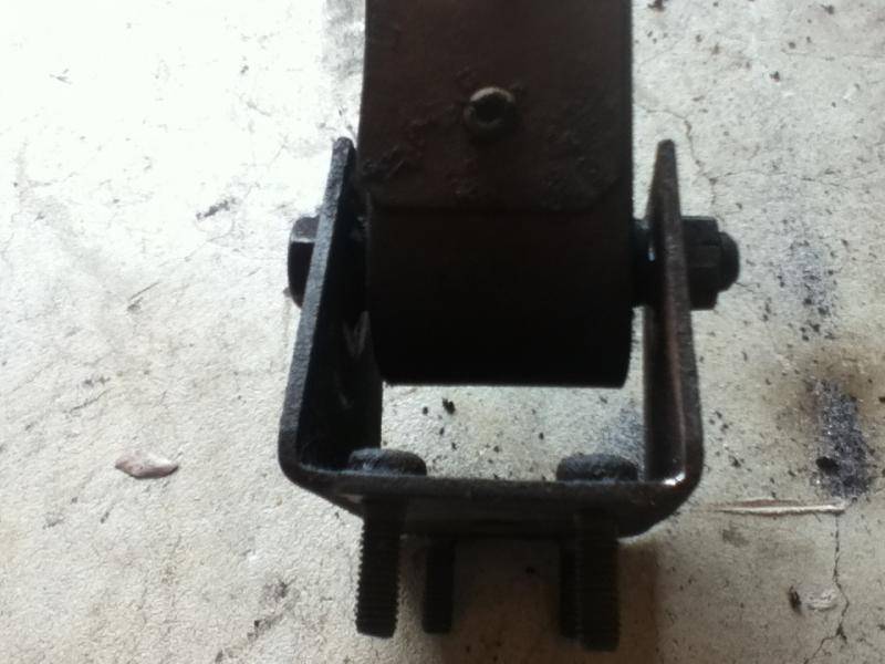

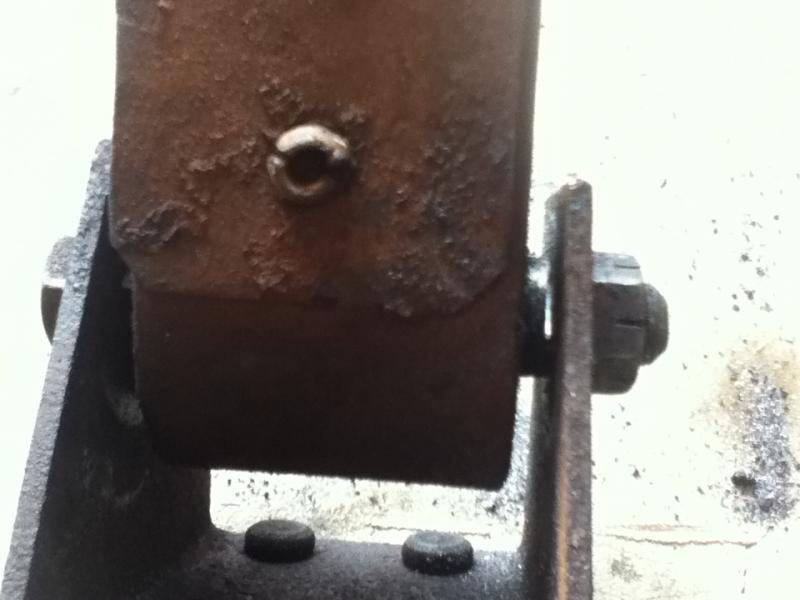

Are the front spring brackets (hold the eye part at front of the leaf spring) sold anywhere?? This is a ***** cutting through...and even than, it appears like the metal of the bolt and bracket have actually rust/fused together.
I don't think the hanger is sold new anywhere.
I've taken those apart with my impact, but you can torch the nut or the head of the bolt off... or grind the nut in half.... or nut splitter.
Any of those methods are going to be much easier than cutting through a hard bolt.
That's gotta come apart....use a black pipe for leverage...do I gotta come down
LOL you guys are rough. I've cutting at the damn thing all morning and have only got half way through the bolt. But that's not my biggest worry...the nut is like it grew out of the damn bracket. Its not gonna just pop out.
