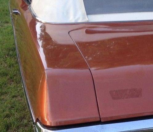

Obviously the top is not original and it looks to be installed incorrectly.

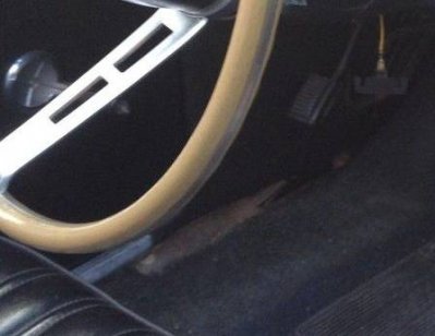

Look at that carpet. Cut short and a nice water stain or what appears to be a water stain.

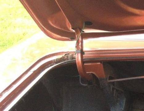

Is that rust at the leaded in area or just a hole where the filler is? A little curious as to what is going on there.
