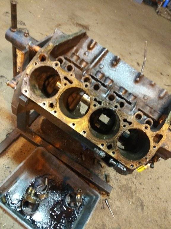

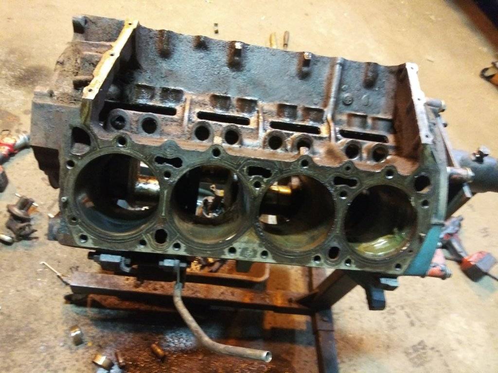

After almost 2 years of soaking in PB blaster...the #s matching 383 is apart! I imagine the block will clean up. I think the crank is a goner. I am now certain it was parked because of an Oil issue. The bearings and crank are smoked.
I see a trip to the machine shop in your future
Me too. I'm just glad I got it apart without hurting the #s block. I'm planning on using a 70 440 in this car, the 383 was on a stand and it was time to get it apart or get rid of it.

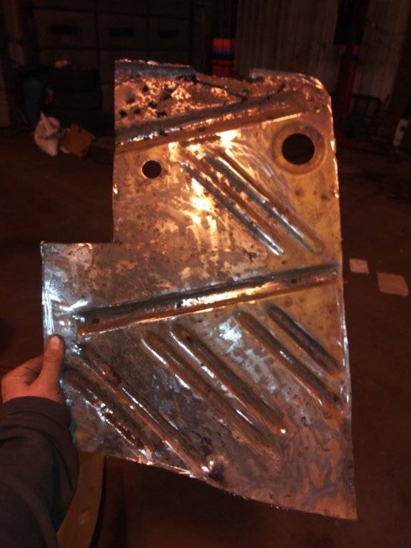

I have gotten some more spot welds drilled out and patches for the floors ready. I'll get pictures of that tomorrow.

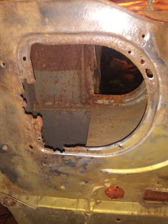

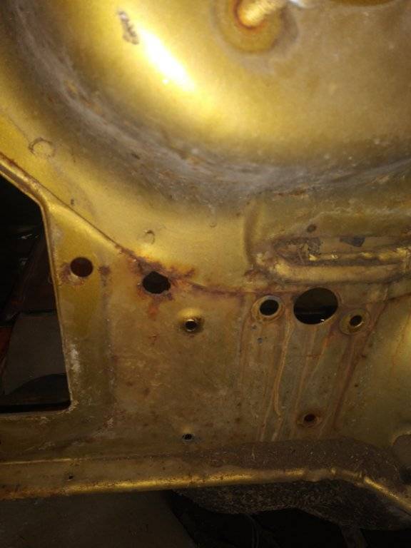

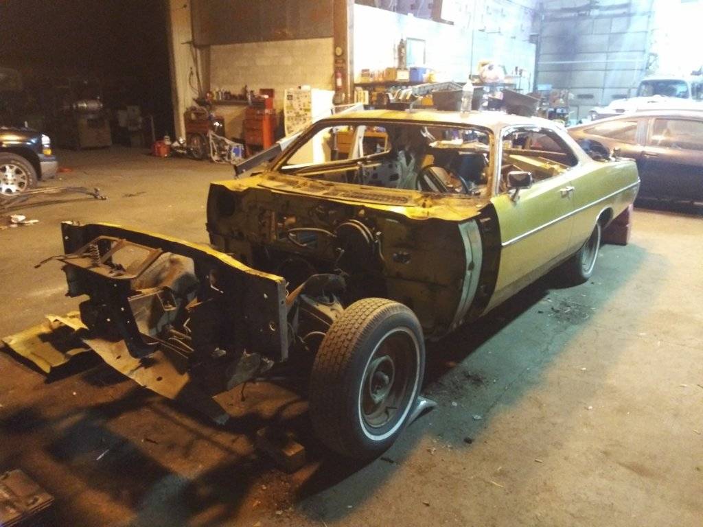

I guess now is the time to pull the front end apart. I need to remove the heater box. I know I could drop the inner fender and get to it that way but it's all gotta come apart anyways for rust repair around the windshield Started with the front bumper and grille tonight. This front bumper is nice enough to find a permanent home on the Monaco, and I have a really nice one I got from Dave I will install on the Brougham when it is time.

Rotted cowls are the tipping point for me on these cars. Unless the car is really special, like a Sport Fury GT or Hurst or by some strange reason the rest of the car is really clean, it becomes a parts car once the cowl is gone.

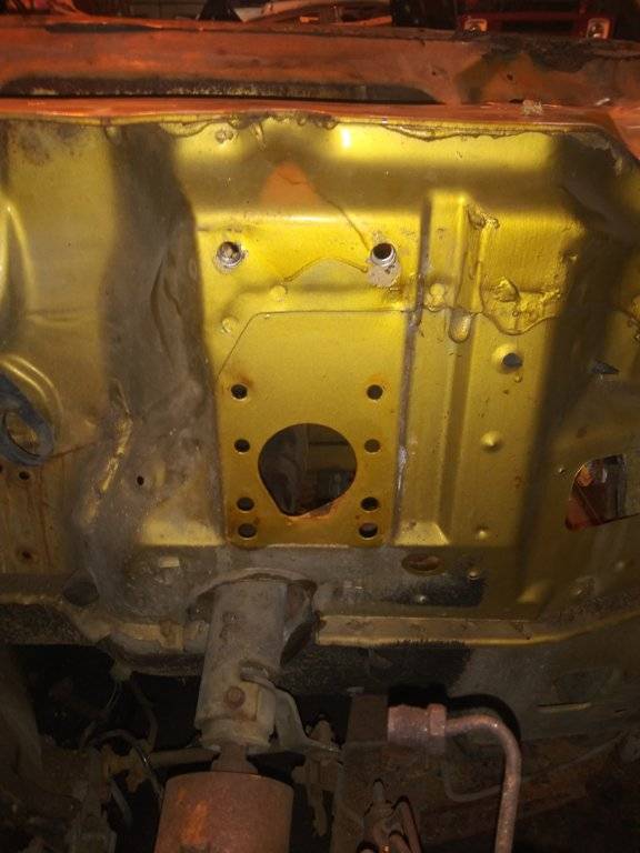

Friday night fun. Had some help from a couple good friends. Got the firewall stripped down. Only thing still bolted up is the column for now.

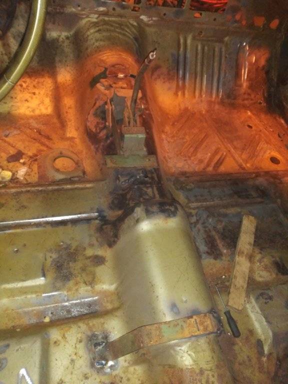

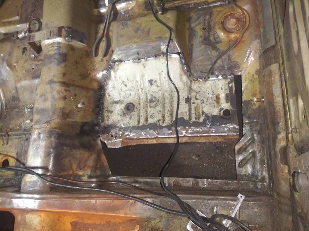

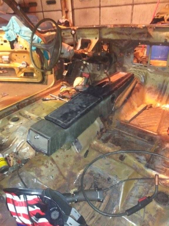

I got the console brackets welded in place and test fitted a console to it. Nailed it. Got some rust to cut out and patches for the floors to trim and those will be burned in over the weekend I am hoping.
Thanks for following. More to come.
It's hard to tell from the pic of just the shifter, but is there a large hole in front of it?

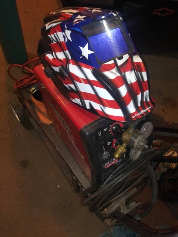

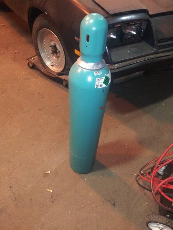

Sunday nights update...I ran out of shielding gas when I started tacking in a patch for the rear footwell. So I figured I would show off the welder making this project solid again. Lincoln 140. 110v. I am running .030 wire.
