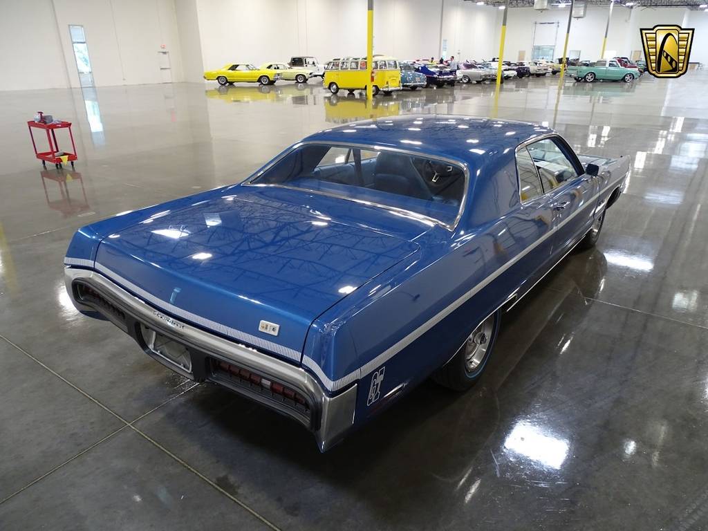

Not a real GT which is immediately obvious from the side picture showing the roof line. Would be nice if someone could go in and take a picture of the fender tag then we could lay this one to rest.

The VIN on this car is PH29G1D103210, we were told that this is a original Sports Fury GT by the owner but have not verified. I have driven this car and can say it runs very strong and is in great condition, please feel free to give me a call at the numbers below if I can answer any questions for you,

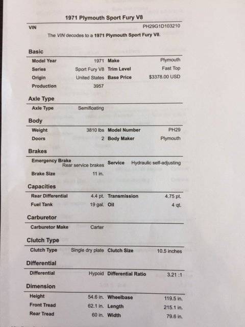

Thanks, Tom. However the big difference is that it’s not a “GT” if it was it would have come standard with the 440 and much more collectible than a “regular” Fury GT. Not to run down the car, it’s a great car, but just wanted to let you know for your own information. Thanks for being forthcoming with the VIN info, and good luck with the car.

Hi Dale,
Attached is a copy of the VIN decode sheet from www.decodethis.com showing this as a original Sports Fury with a 318 CID , the 408 Stroker is a nice upgrade and makes more power than any engine Plymouth ever put in this car!
