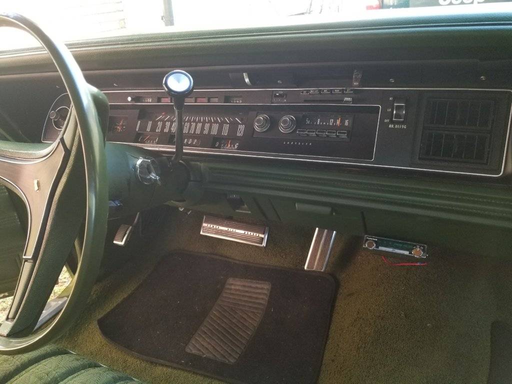

Has anyone here ever taken the instrument cluster out of one of these? I tried to take out the dash clock and now the speedometer doesn't work. I took all the screws out of the black piece with the lights in it, pulled it off, then tried to pull the part with all the gauges out. It wouldn't come out further than an inch so I didn't force it. I just put it back together and left the clock alone. Well I discovered on a test drive that the speedometer doesn't move now. How do I fix it? I would still like to fix the clock, how do I get it out? My dad said I probably pulled a cable loose.
By the way, the steering was much tighter. It is still loose but much safer. It was hard spending 400 miles trying not to drift into the next lane.
Dad's right about the cable, I'm glad you're addressing the cause of the loose steering.
Pulled the plastic end off the cable sleeve.
Do you mean the end that goes into the speedometer? It is pink, and I can't get the ends to connect, I think I may have broken it. That panel is a HUGE pain in the behind to try and get out! Is getting the sleeve there what I need to do? - thank you
It usually comes off the cable sheath and the drive cable inside will not reach anymore

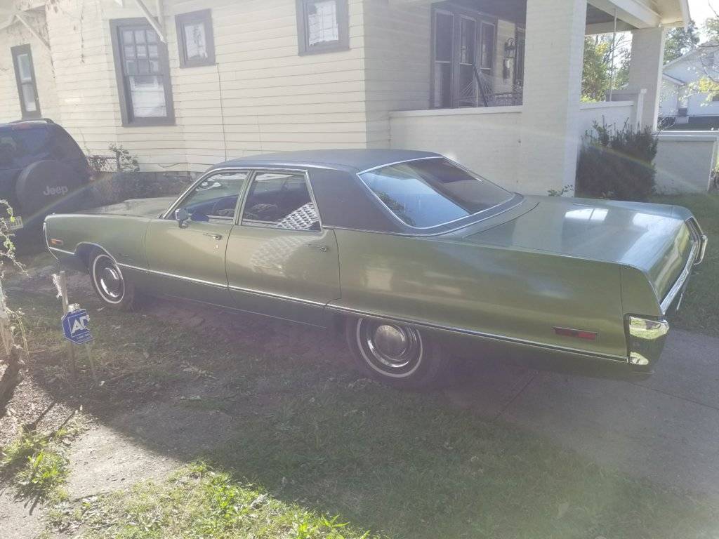

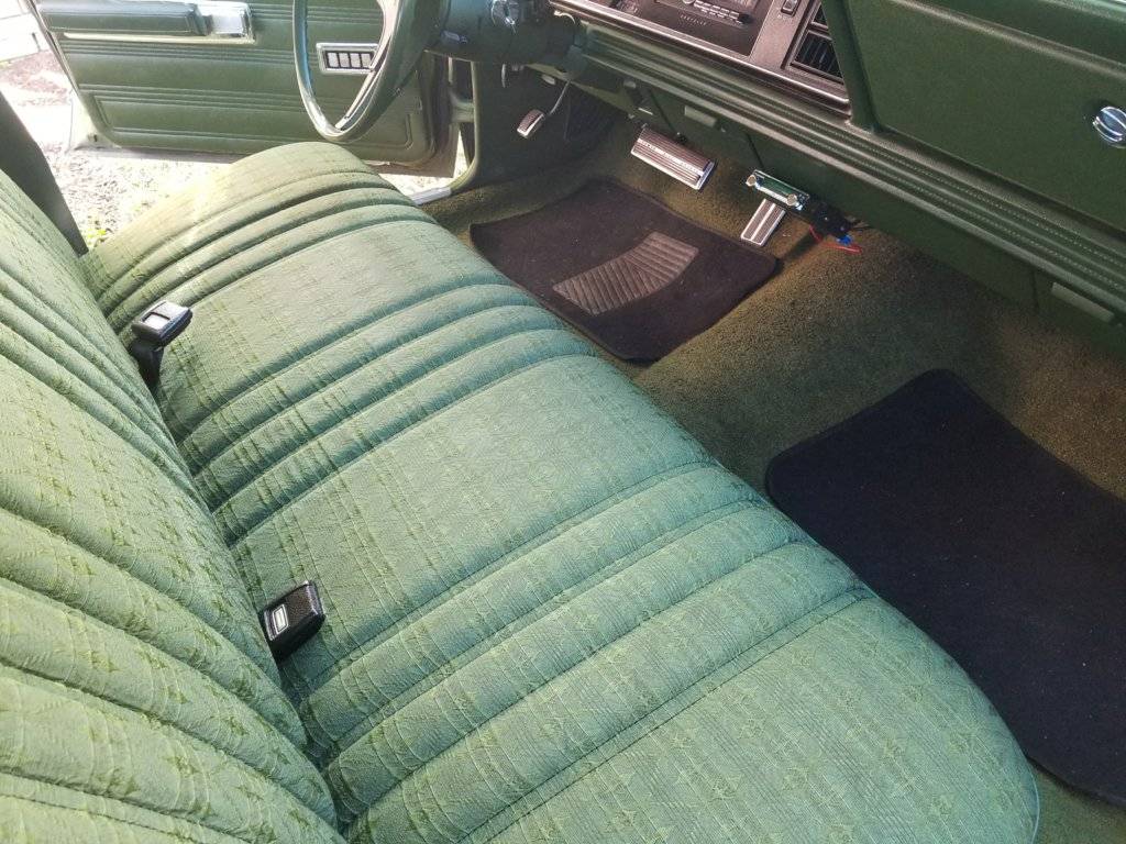

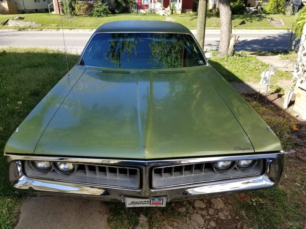

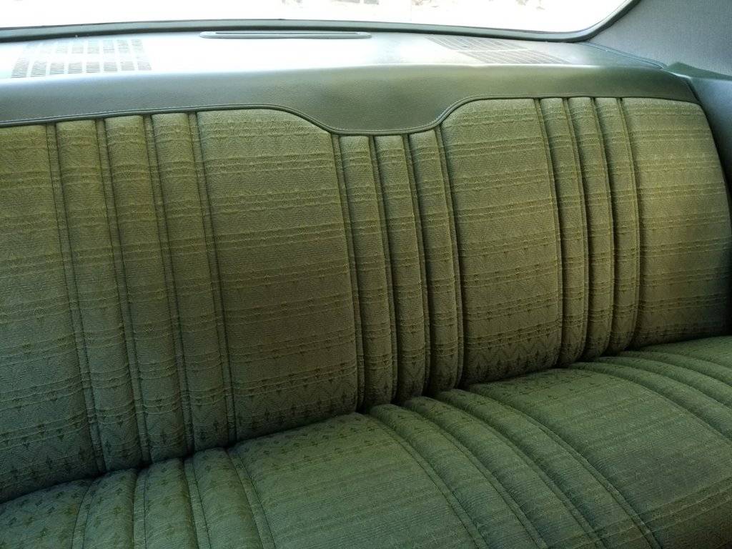

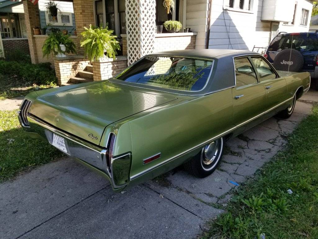

Here are some more pictures of "The Tank" you wouldn't believe how many rides ive been asked for, haha.

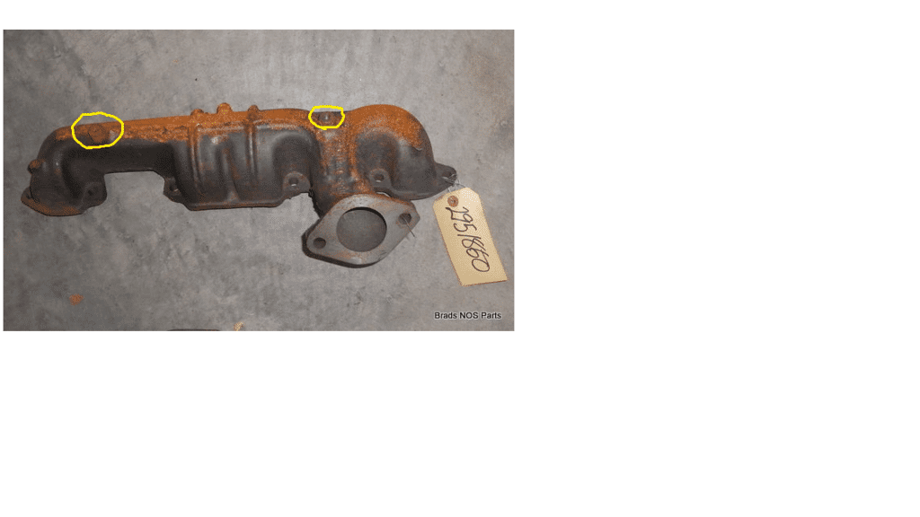

4. Pertaining to the possible exhaust leak, I took a look. The bolts were tight, but on the left side of the car the manifold has two screw holes. Should they have a screw in them? Is there something missing that should be screwed into it? I find two random screw holes odd. There is a picture below to show you what I am talking about.

4. The screw holes may be for a heat shield
