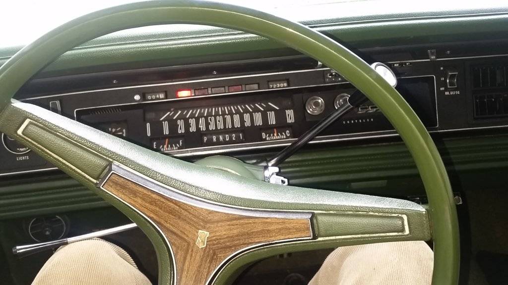

I took a video but I cant figure out how to get it on here. Here are some pictures instead. I jacked up one side and did the best adjustment I could with one side off the ground. After what I could do, the slack is MUCH better than before. It is almost near normal. The pictures are with the car off, wheel far left, and right. This is how much slack there is before you start turning. I have not driven the car after adjustment yet, but it is a million times better. Oh and that buzzer when the key is in has to be one of the most annoying sounds I have ever heard - thanks Chrysler!
I took a video but I cant figure out how to get it on here. Here are some pictures instead. I jacked up one side and did the best adjustment I could with one side off the ground. After what I could do, the slack is MUCH better than before. The pictures are with the car off, wheel far left, and right. This is how much slack there is before you start turning at all.
