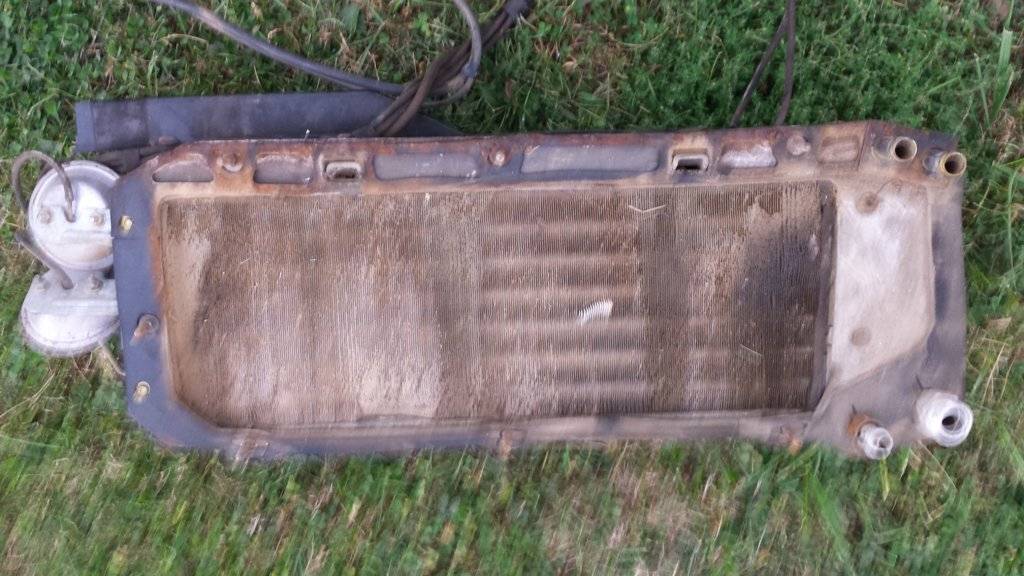

Hey Jon have a used heater core / a/c evaporator assemb. Heater core is good, not sure about the evaporator. Can give you a detailed info removal and install. Whatever you do get a a/c heater box restoration kit from Detroit Muscle Technologies. It will have every gasket you will need to due this and save you from many headaches. If interested I will Pm you photos of it.
Yeah I'm interested, but I'm in no hurry. Send me pictures whenever you get a chance. How much is it? Thank you.
Her it is. Heater/evap assemb. Haven't removed it from heater box yet. Price is 75.00 + shipping. Pay w/ cashier check or money order.
