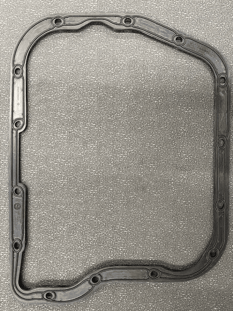

The A904/A500 pan gasket is P/N 4295875AC. It is used in Dakotas/Jeep XJ's.
I use either Indian Head or Aviation seal or even Hi Tack on many places but I try to avoid using anything besides a gasket on a trans pan.
^This^
Best trans gasket period. And it's even reusable. No sealer needed.
Is 02464324AC a substitute? Amazon has that. If not can you suggest a good source for 02464324AD please? Does it need longer bolts than stock? I read that somewhere. Mine is overdue for replacement. Thanks in advance.

Yes, they are the same.
The stock bolts are plenty long enough.

Both have 14 bolts, pans have different shapes. From the b bodies only site:
https://www.forbbodiesonly.com/moparforum/attachments/727904gasket-jpg.455772/
