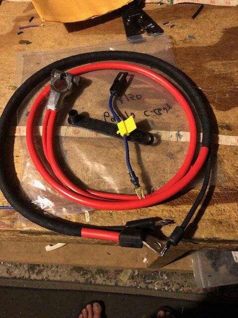

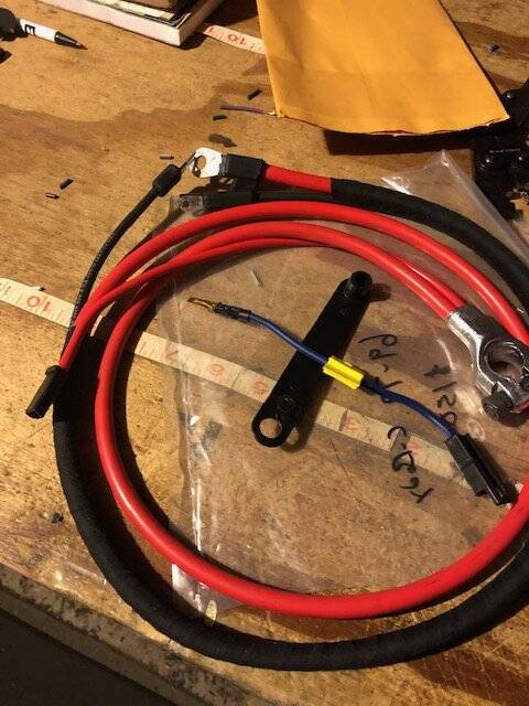

Any experience ordering battery cables from Mr. Evans? I need a positive cable for Snow White (P/N 2983499 ), and his company makes them.
Then I hope you are happy and I am wrong. He is a regular vendor at Carlisle. When I have asked he has told me no he doesn't.
If indeed he has the 100% correct cable with fusible link, please let me know asap. Missouri needs one bad ...
I've asked him for a photo, precisely for that reason. Can you check the P/N that I gave above ( 2983 499 ) is the one on your Polaras?
He has told me explicitly, twice, that he has the correct cable for a 1970 Polara with V8 and the above part number. I’m ordering and everyone will know if it’s incorrect. I’m betting it’s correct.
PS: is the fusible link part of the cable? He adds it as an option.
Take the option, and a photo... please to share with the world.
Here you go:
