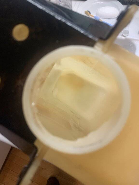

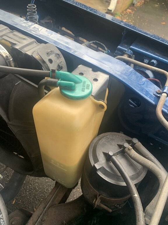

I cleaned the green cap with a cotton swab, after I took the photo. I need to fix the metal tab that is sticking out on the radiator.Stunning clear! Great! I love if peoples give attention to the Details - that is Car-Love![]()

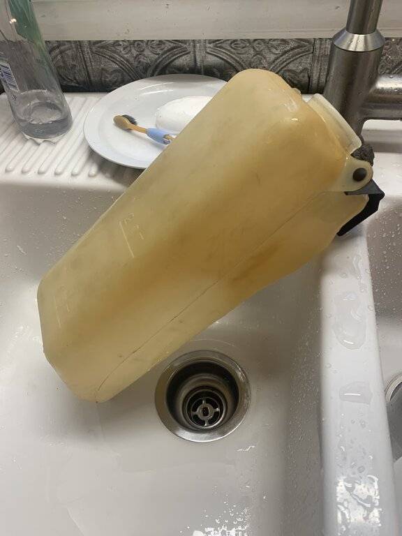

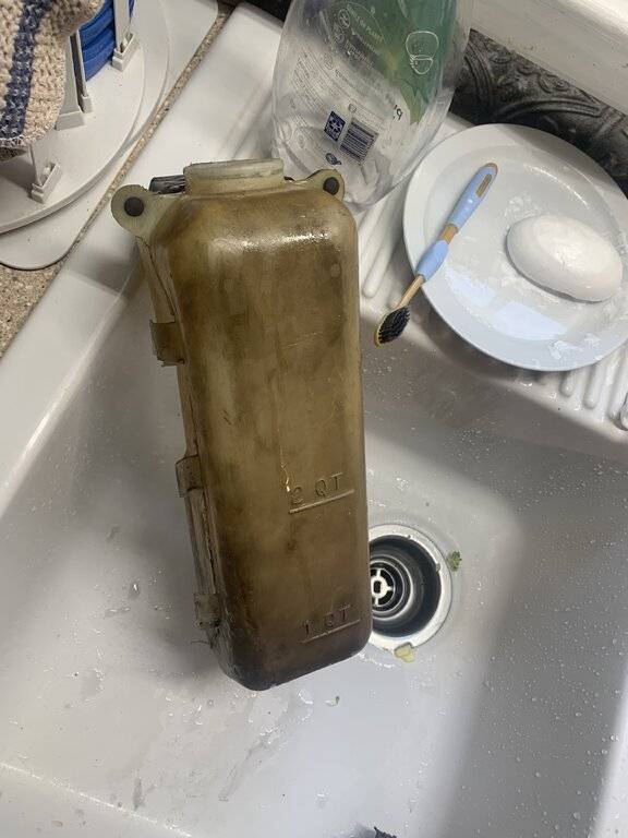

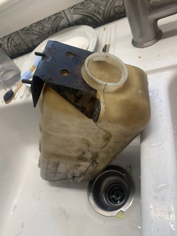

Outside- clear dish soap and a kitchen scrubbing pad, and steel wool on areas with hard to remove stains. Use fine steel wool. #000. The plastic is VERY tough.What did you use to clean the bottle?
I haven't tried it yet, but I read about using apple cider vinegar on the inside of the bottle.Outside- clear dish soap and a kitchen scrubbing pad, and steel wool on areas with hard to remove stains. Use fine steel wool. #000. The plastic is VERY tough.
Inside…the “secret sauce”…
Kids sandbox sand…”play sand”…very clean.

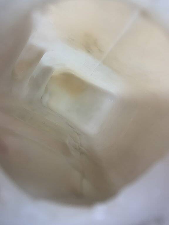

Put in about 2 or 3 cups. Add just enough water that it becomes a kind of slurry, like a milkshake. Put your hand over the opening and SHAKE! It takes a little time and effort, but it’s very effective at getting everything. It’s good because it gets all the brown residue off. There are no little orifices or hoses for the sand to get stuck in, so you can just rinse it thoroughly once finished. I was very pleased with the results.
I tried using a clothes drier lint filter brush at first, but that didn’t work very well.
That's because the baking soda neutralizes the acid in the vinegar and forms a gas, hence the volcano. Best to use only vinegar and let it soak for a while or it won't do anythingI actually tried vinegar and baking soda first. Didn’t do much. The old grade school volcano. Just fizzled.
