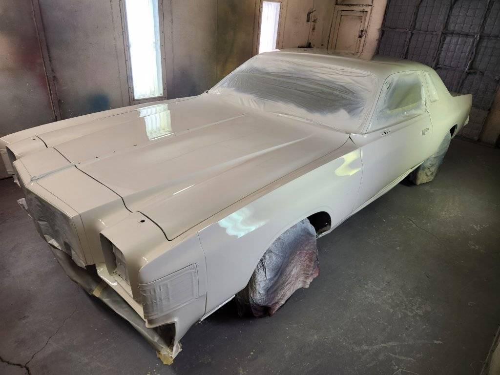

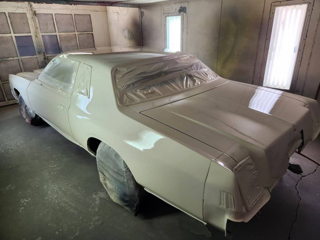

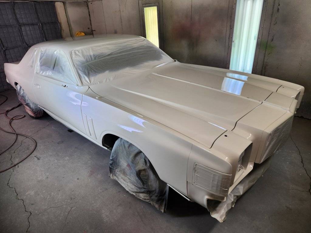

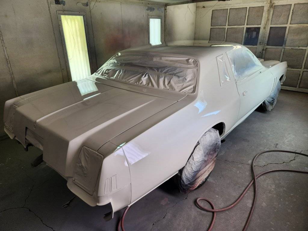

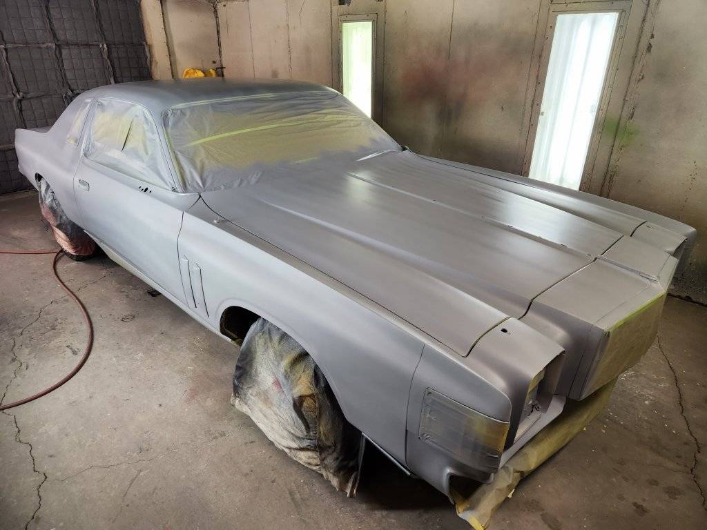

Hood stripped, all sanded and in the booth. Gonna mask it and prime it next.

Ok all sanded. Just have to clean it up, then mask it and paint it! Going to be a rare but desperately needed rainy weekend in the desert so it'll be Tuesday or Wednesday before I spray it.

Yeah, made a living doing paint and bodywork for 45 years. Definitely have done it before!

I believe it is the same color Steve. I tried something different and bought it from TCP Global off of E Bay. It's a single stage acrylic urethane. Went on very nice. Reasonably priced at $224 for the gallon of paint and a quarter of hardner.
I meant to ask earlier. Why didn't you remove the front fender louvers before spraying?
I removed 4 of the 6 but the last 2 are stuck on good. I was afraid to break the plastic if I hit them too hard. Not sure if the previous owner glued them on or what .
I am pretty sure they are left- and right-handed (2 different part numbers). If installed on the correct side, then push/slide upwards to remove. If not, then push downwards to remove.

I didn't try taping down. All the ones I took off came off by tapping up. In fact none of them were hard to remove. They were actually too loose.
