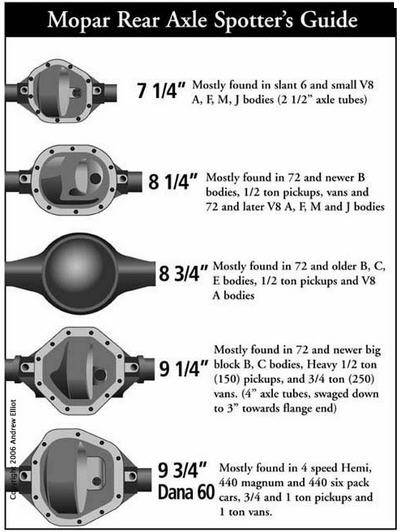

'72 fury with a 400 should have an 8.75 rear end. If the rear end is a 3rd member type it is an 8.75. If it has a bolt on rear cover, it is probably an 8.25 but there was also an optional 9.25 available.

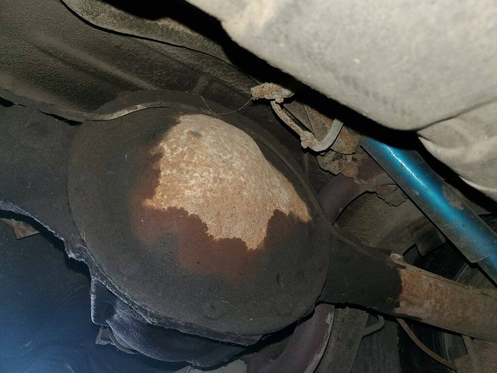

Is there a section of the car that tells you what rear axle you have?

Look at your build sheet, the type of rear end is coded. I also sent you the photo ID earlier.
Dave
Thanks dave looks like i need to find an 8 3/4 then. No idea where a build or broadcast sheet would be on it.

substantially stronger. If it's the right width and perch set up and a gear ratio you want it could be a deal.
