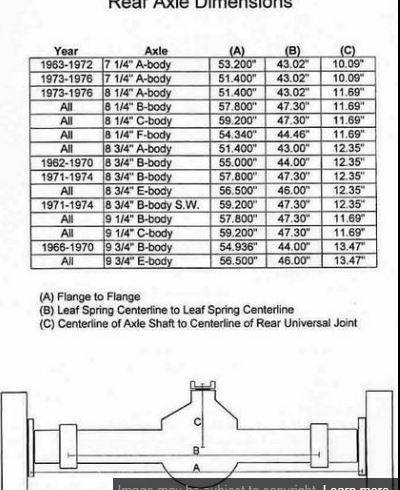

First of all would this fit a 1972 Fury III, I presumed it did and was told it did so I purchased it. it is 47.30 between axles. Any issues with length of axles on Fury v Imperial

Chrysler adopted the "Torsion Quiet" suspension system in 1971, so both the 8.75 in your 72 and the 9.25 from the Imperial will both share Iso clamp perches. They make poly isolators now to firm them up a bit ...the way to go for a driver in my opinion.
Track width for the 70-73 C body was 64 3/8 inches and a perch width of 46 inches, and the Formal had 63.7 inches track width and 47 3/8 inch perch width, so it's not a bolt in if that's what you're after.
Some cutting/ welding of the perches would be needed to make it fit.
If you're on the cheap, it's up to you how best to spend your money...either spend the coin making the 9.25 fit and rebuild it, or rebuild your 8.75 pig with sure grip and the desired ratio.

Reading this I thought it would be a bolt on - but you say the fury is not 47.3 - I am looking for a strong rearend to withstand my 500 hp motor,
What is the spec for the rotors? I can post picture tomorrow of rearend, it is in really good shape with new calipers so I thought a buy, but not if it doesn't fit
Sound like the 9 1/4 will take some adjusting, Thanks you for your information
WAIT!
The above chart shows the C body 8¼ as having the same dim. as the C body 9¼.
Logic should follow that the 8¾ should be also.
Im of the opinion that the C body 9¼ is a plug n play.
Yes? No?
That chart isn't 100% accurate. I got some flack before for posting it on FABO.
8.25 did not show up in C body until 1974 with low output engines. 8.75 went away after 1973, so no go in C body because fusie to formal body change.
Yes? No?
Here is what I know... very little, but my 74 imperial rear end wound up on my friend's 71 satellite/RR wannabe, when I asked he said it bolted right in. IDK which car he used shackles from... point is, this guy has the car and the rear... TAPE MEASURE TIME.

Need to breakout the C_body specs from a 1970 book and a 1974+ book and put them next to each other. That will be definitive.
Mr C: where did you get you C-body 8¾ dimensions from.

Spring perch widths (center-to-center)
A BODY’66-’73: 43″
B BODY’62-’70: 44″
’71-’74: 47.3″
C BODY’65-’73: 46″
E BODY’70-’74: 46″
Intersting. Figures that Formals would be the oddball.
A BODY’66-’73: 43″
B BODY’62-’70: 44″
’71-’74: 47.3″
C BODY’65-’73: 46″
E BODY’70-’74: 46″
My 2 cents A bodies are the same through out their life, why the arbitary 66 which is the last year for first gen "A"
goes all the way to '76
B body should be same from 71-76
C body formals changed the floor pans and rails, front suspension changed also.
