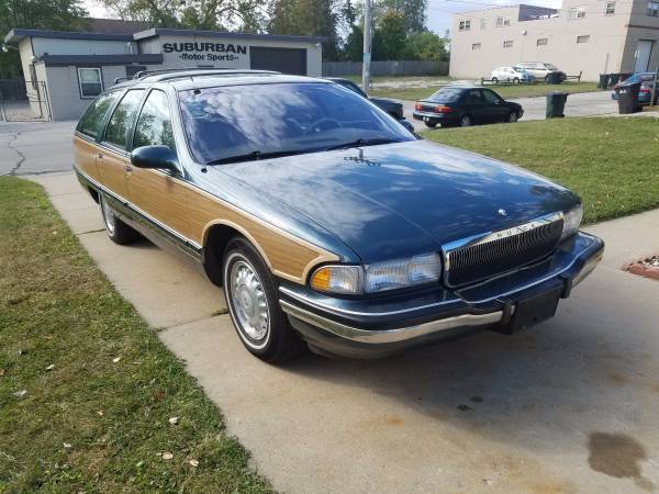

1995 Buick Roadmaster Estate Wagon
1995 Buick Roadmaster Estate Wagon - $3500 (South Milwaukee) hide this posting unhide
< image 1 of 5 >
1995 buick roadmaster estate wagon
fuel: gas
title status: clean
transmission: automatic
QR Code Link to This Post
All original survivor!
116K original miles
5.7 LT-1 engine
Loaded leather
New - tires, brakes, starter, battery, water pump, distributor
Runs and drives great!
$3500

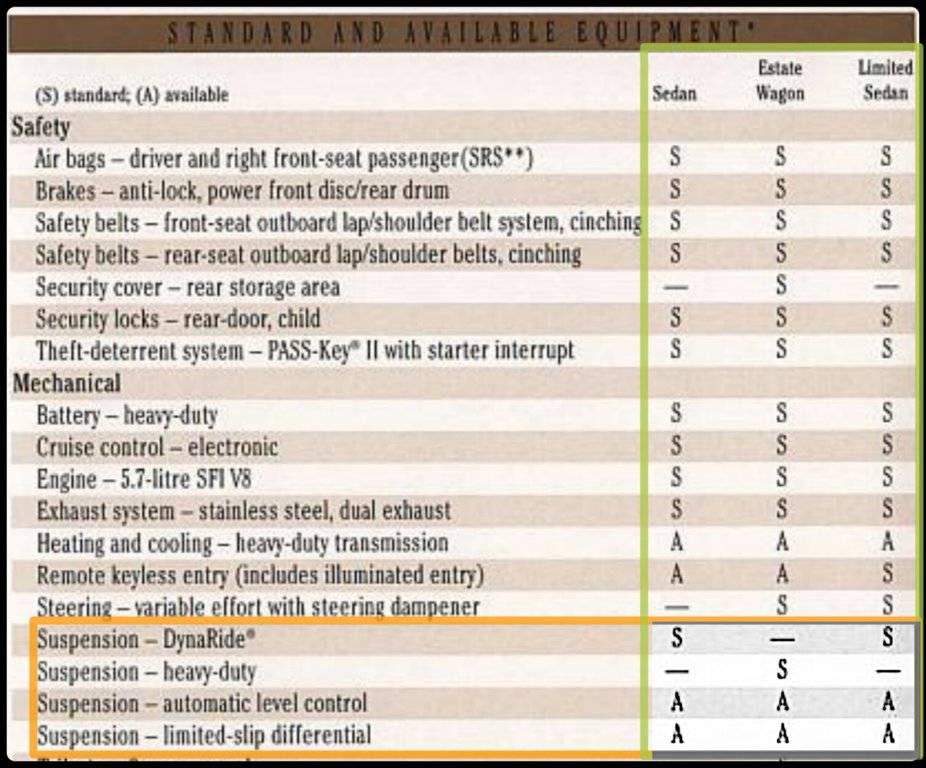

Mine has the hydraulic front stabilizer, but the dynaride according to the chart was not available on the wagon! Whats the difference between dynaride and automatic level control syspension? which is what I guess I have. Thanks for clearing up the rear sway bar question! Thanks to Pete I now know a hitch off a 81 to 96 Estate wagon is the same!! Wonder is that's the same for Chevy, Olds and Pontiac? Should make finding one much easier!!
DynaRide was simply a used by Buick for the STOCK settings of the standard settings. Each division had their own unique stock settings.
If you had a wagon, you had the DynaRide stock suspension with HD springs and shocks.
The hydraulic stabilizer was eliminated when the car had the air suspension. WHY? I'm clueless.
EDIT: or maybe not. :lol:
