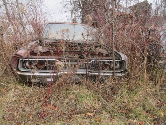

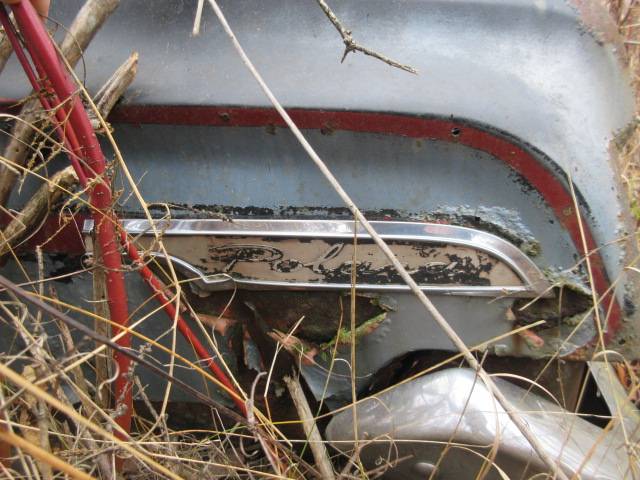

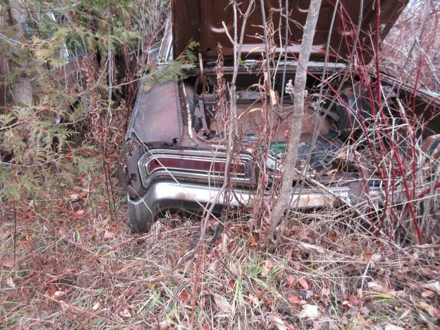

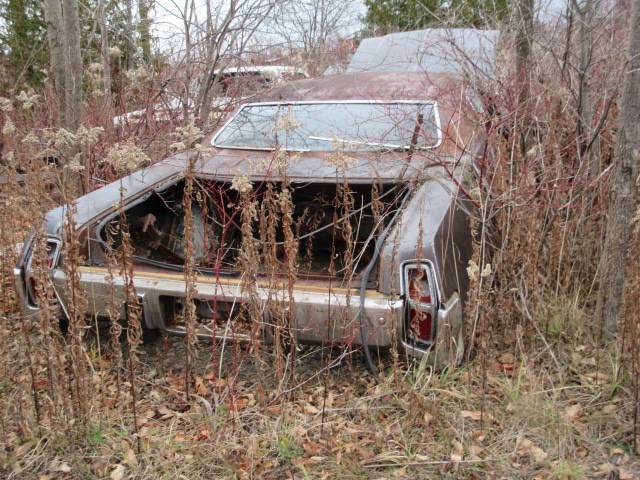

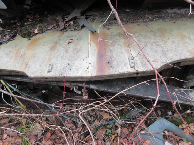

Like I said , lots of cars are pooched as you can see in the pics below, but some good parts. Many Mopars I haven't shown and I still have 2 fields to check out. As shown, it's rows upon rows of overgrown brush consuming the cars especially the older ones.

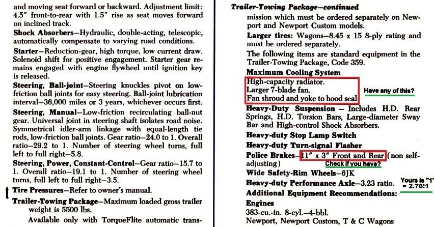

Mark, let me know if you figure out if my Newport was factory ordered with a tow package, it does have the plate at the back.
Thanks PT
...let me know...tow package...
We'd need to see your broadcast sheet to determine that for certain.
M
*Edit to add image - If factory equipped, you broadcast would have a "9" in the appropriate box. This example did not come with factory trailer tow.
Looked through the dealer literature a bit. A few items lead me to believe your car was not factory tow. I find no provision for a "dealer-add", either - only "Load Stabilizer Unit" (coil-over shocks).
FWIW
