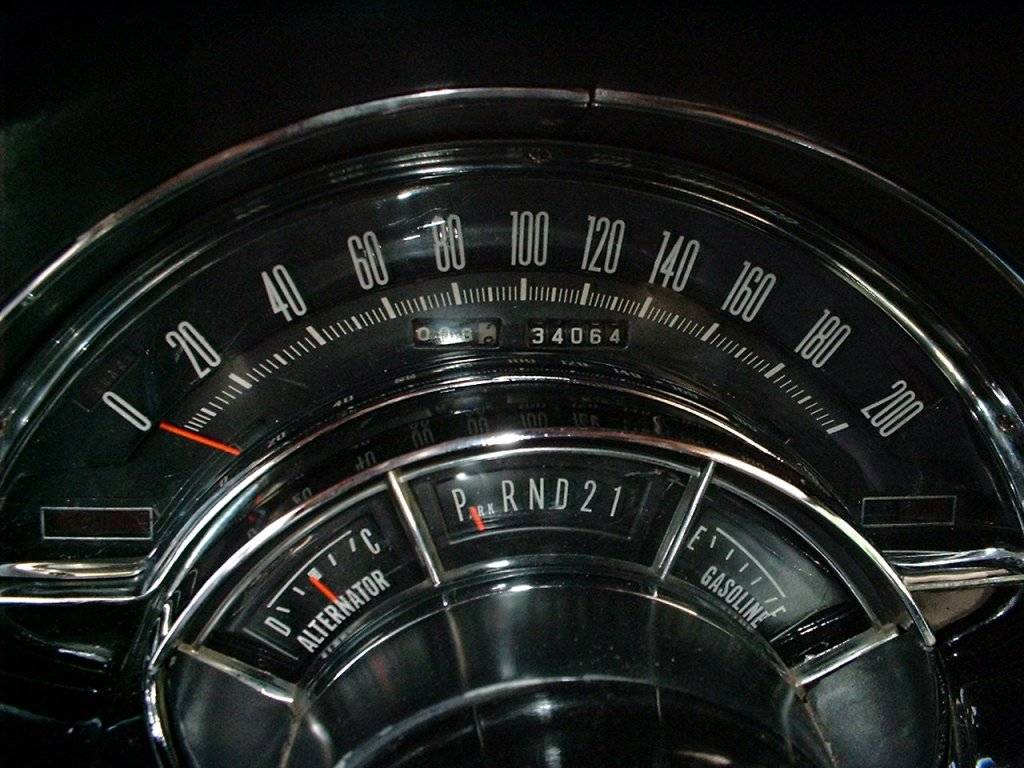

Canadian cars didn't get kilo speedos until the mid 70s.
Got it. Kilo-speedo code 684 must have just been for European (or some other metric area) exports then....
Yup, but if one looks hard enough one can find KILO speedos out there - either used from export cars in Europe etc., or NOS in parts stashes.

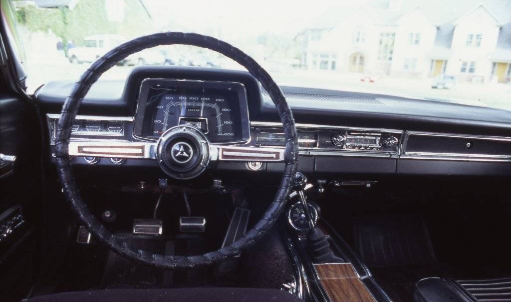

KILO speedo for export-built 65/66 Canadian Dodge Polara/Monaco and Fury (USA and Canada)
(sourced out of Finland, installed in my Canadian 66 Dodge Monaco)

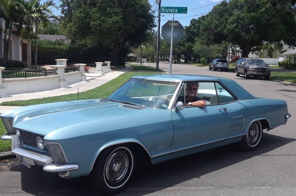

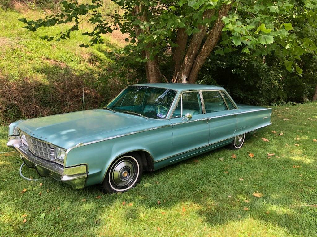

Hi polaratherpy, somehow I missed this thread last month. Great looking Newport! You will love that car. I sure love my 67 Newport Custom, it's my favorite. Don't tell my '65 6-window Town Sedan or my '63 Riviera!
Cheers from Tampa, Rich

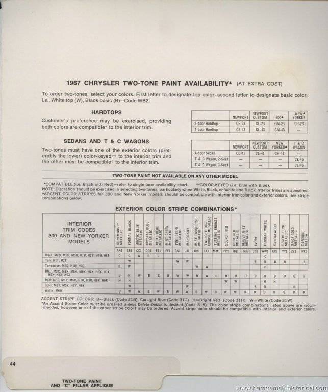

Regarding the paint, the paint code on the fender tag is BM2. I did some digging, and based on what I have that means that it was a custom paint order with a black roof and turbine bronze body. Sharp!
my 67 Newport has the painted black top with gold main body, and the original window sticker shows the painted top cost $17.00 bucks.

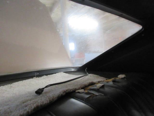

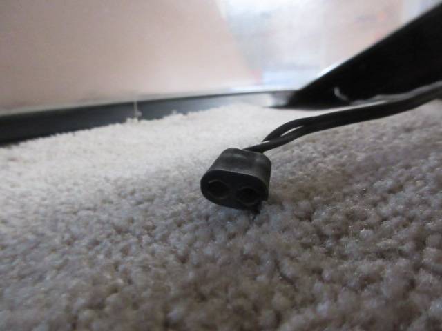

Happy Holidays, wondering if someone can help me indentify this cable, I found it tucked in on the rear deck on the driver's side. I've looked for it in the service manual but it eludes me.
It's a 2 wire and about the right lenght to go to the rear internal pillar light.
Just wondering if it was forgotten when all the panels were put back together from when the vinyl roof was put on.
Thanks in advance,
PT
I'm thinking that usually the wires for courtesy lights are just one wire, the positive, and the light fixtures ground to the body. In this case, there are two wires, so maybe it's for a speaker?
The oval 6 X 9 spots in the deck have not been cut out so you may be right that it was an external spkr that just sat on top of the deck.
I agree that all lights use body ground, also could not find that type of conector in the manual.
Thanks Richard

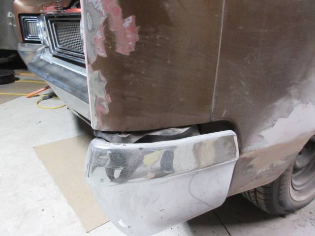

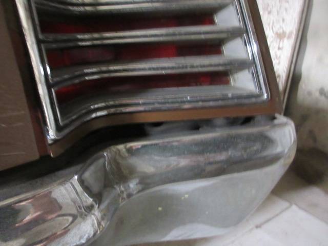

The fillers hide the gawd awful factory gaps and also absorbs any impacts from parking lot wars.
Your fillers are fubarrd from rust check or ziebart that really screw them up.
The bumpers do need to come off to replace them.
Not in reppop, NOS or good southern used ones will do and make sure they have the clips.
Hope this helps.
Hope this helps.
I may just remove them, thanks for the info.

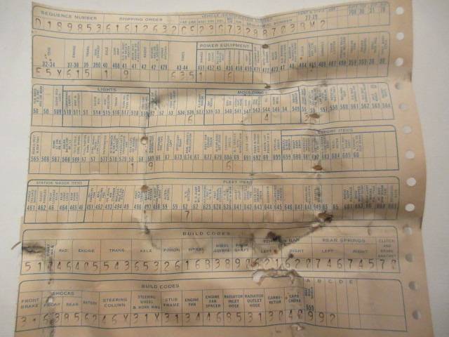

Well got around to pulling the back seat out and found the BS and a spare set of front bumper signal light lenses tucked behind the seat. Odd thing is the car should be Turbine Bronze yet it's painted the same metalic brown inside under carpet and seats as outside, it must have been a total redo somewhere around 1979 according to the newsprint under the back seat, all soaked in oil or something.
Between the trunk and the back seat section I must have vacuumed up 3 Lbs. of sand ?????
Anyway here is the BS, not sure what 6 print is under 536 or any of the other codes for that matter.
Please let me know what was ordered. Thanks PT
Ayilar is the fender tag guru, who is the broadcast sheet guru?
67 and 68 cars they use the last digit on both the fender tag and broadcast sheet.
For example, on your sheet axle code 401 is 2.76 gears. On the tag it is stamped "1" under AX
I tried blowing up your sheet but it gets very blurry.

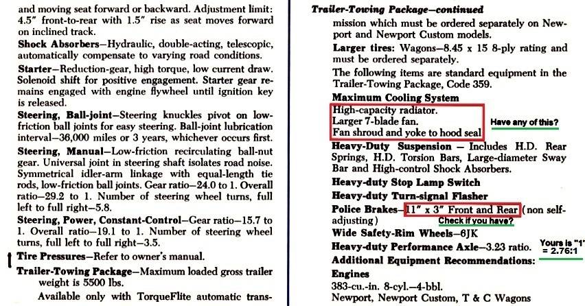

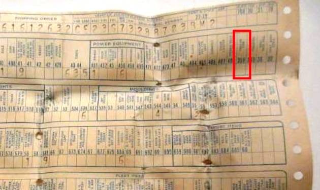

I believe this to be correct - 536 happens to be the code for a remote outside left-hand mirror. I think that's the only code I see on your broadcast in a 'completely undescribed' slot. The other code boxes are as @cbarge says: - if the digit prints below it, the car gets whatever the thing is that's described in the box above. Often, there can be more than one digit that is valid (like the axle and the transmission) - for example: the first "42_" for "Radio" can be 0,1,2,3,5,7,8 - each one denoting a different radio option (420, 421, 422, etc.). The second "42_" can be 424 for rear speaker with reverberator, or 426 for rear speaker without reverberator. Blank = no rear speaker installed at all.
BTW - I'm sure you already looked, but back to one of your original questions:
Box for code 359 "Trailer Tow" is blank, so your car did not come from the factory with a towing package.
@69CoronetRT dabbles in some years of broadcast sheets and fender tags. At least later ‘60’s.
@PeugFra dabbles in the early -mid 70’s and have interest in these things.
But may need a clearer picture of the BS
