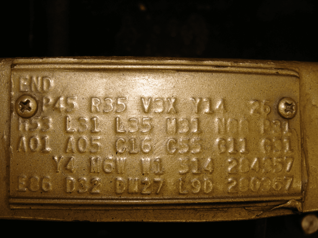

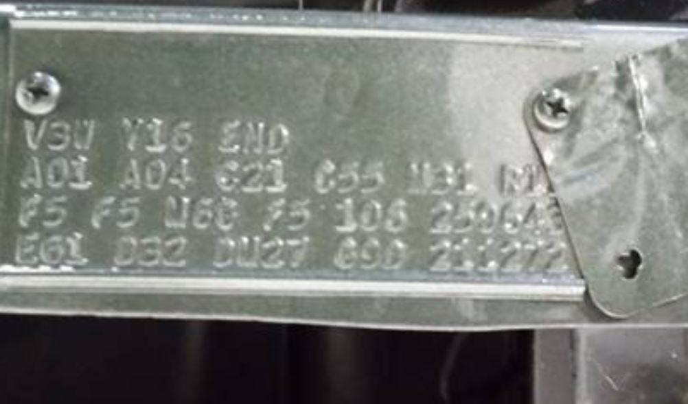

Okay ….…...can you show me a fendertag-picture with DM27K9...…. ?
So, L code only dm27L That's the only 440 motor available on the polara 500 in 69. Correct?
I'm new to the big car letters and numbers so please bare with me. just wanted to make sure I'm reading what you guys are saying correctly.
You are correct and I've been corrected. BUT, be aware that 69 and earlier L was the code for the High Performance 440. Marketing for the 440 HP was Super Commando for Plymouth, Magnum for Dodge and TNT for Chrysler. 70 and later U was the code for the High Performance 440. The only larger engine installed from the factory in a C-Body was the optional V code 440 6-barrel in the 70 Sport Fury GT. IMO the 69 Polara 500 with the 440 HP is very cool, probably pretty rare and should increase the value.
