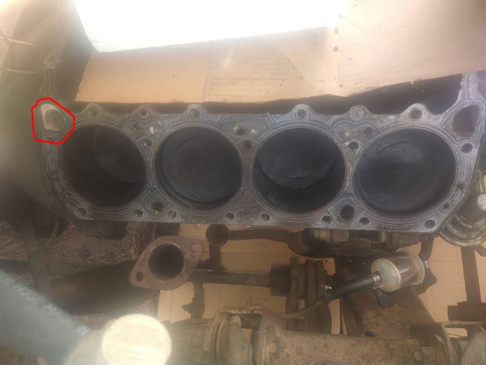

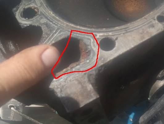

GUESS WHAT? I just popped the middle expansion plug, and, like yours, mine too is CHOCK FULL UP TO THE RIM OF THE PLUG WITH CRAP!!! Special Thanks to Brer 413 for his Sage Advice. I DIDN'T WANT TO DO IT, but, after shining my trusty green "Eyeball Burner" laser into the upper ports, I noticed that the FRONT was DRY and EMPTY, while the BACK was yet FULL OF COOLANT! So, I then removed a perfectly sound steel factory expansion plug, and found, "paydirt" ALL THE WAY UP TO THE RIM.

Yes, Tamara, my Balkan Babushka agrees. I even had a rubber bung to pop into the expansion hole on the passenger side, as I suspect I'll want to open it a few more times before finally closing it for good. I need to order up a pair of fresh boat/bathtub plugs, so I can have one for the driver side, and a good spare.
BTW, by using a lavatory/kitchen sink snake, I dug out enough of the calciumferro-oxalate precipitate to enable FLOW again in the passenger cooling jacket. The compressor helped mightily there too., dig-dig, BLAST, dig-dig, then WHOOSH, the trapped coolant ran out!

Anyway, the passenger side didn't drain at ALL o Gertrude, because of that abominable coolant heater. (GRRRRR!) So MUCH of this weeks agony came directly from somebody leaving that thing attached, and open, for possible DECADES to shunt flow from the back two cylinders, and up into the HEATER HOSE RETURN. Consequently, 25% of that engine didn't get coolant circulation, with the lamentable results I'm now addressing. I just thank the Big Boss that His Kosmos didn't cook that head or block good and proper FOR such stupidity.

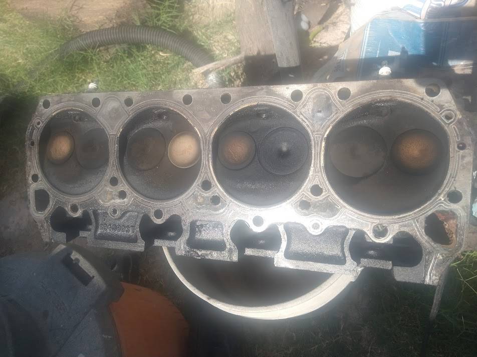

Have a look NOW Elder Moparians:
First, the inner side, mating surface of the cylinder head BEFORE I cleaned it, according to FelPro's own John Gurney's instructions as given here:
Pretty GNARLY ain't it? So, I bicycled to Ace Hardware this lovely mornin' got all manner of brass and fine steel brushes, some razor scrapers, including plastic blades, to DO THE JOB!

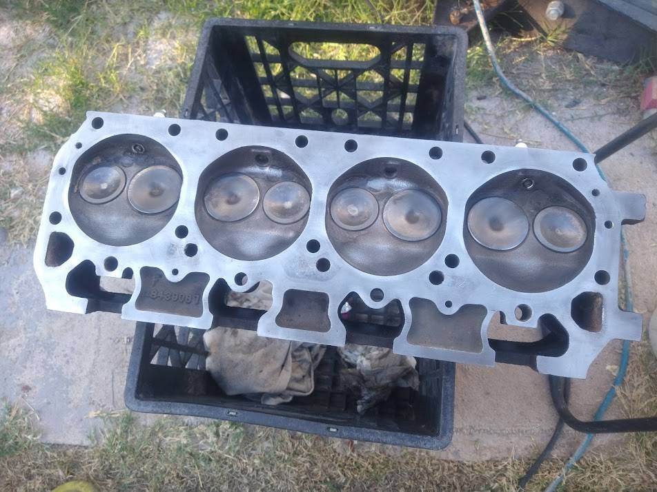

And did it.

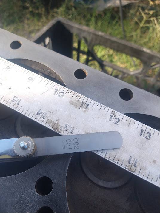

This MIGHT even mate with the FelPro gaskets from the head set kit. I might want to go back to Ace tomorrow for a BETTER STRAIGHT EDGE though, to make SURE. I have a half decent aluminum ruler, good enough for cutting plywood, but its rather beat up and such, and I don't entirely trust it. Also, I have a feeler gauge set that goes to 2/1000" but not the .001" specified by FelPro. I DO think that by burnishing with the fine steel wire brushes after using the brass to get the CRUD OFF, that the finish will fall inside FelPro's RA spec. Looks nice, doesn't it?
And did it.
View attachment 493335 This MIGHT even mate with the FelPro gaskets from the head set kit. I might want to go back to Ace tomorrow for a BETTER STRAIGHT EDGE though, to make SURE. I have a half decent aluminum ruler, good enough for cutting plywood, but its rather beat up and such, and I don't entirely trust it. Also, I have a feeler gauge set that goes to 2/1000" but not the .001" specified by FelPro. I DO think that by burnishing with the fine steel wire brushes after using the brass to get the CRUD OFF, that the finish will fall inside FelPro's RA spec. Looks nice, doesn't it?

Yes, that is not a straight edge but a metal 3' ruler. Machinists straight edges are forged or cast and have a machined edge and are usually accurate to within a .001 per inch. Here's a link and this one isn't even a top quality one. Check out Starrett for some of the best. Hard to justify the price for a one time deal. That's another reason to send them off to the machine shop. https://www.amazon.com/OEMTOOLS-25355-Inch-Straight-Edge/dp/B076ZYJPGR

That's The Plan Bro! I still want to get a better straight edge than my damned old aluminum ruler, but Mama wants to see that head bolted back on. I still have the driver side to do. I HATE pulling the head, BUT, as you know so well, the compression ratio will go down a notch from the FelPro gasket on the passenger side, so, for that reason AND, to better expedite clearing the crap out, I'm going to open the driver side ASAP.
When Gertrude gets done with this Surgical Enema, she ought not suffer fever for a GOOD LONG TIME.
