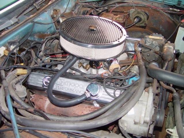

BTW, there is plenty of hood clearance on a Formal to do any combination of carb/intake/air cleaner setup's.

It might not be an issue with the '74+ model years, but hood clearance COULD be an issue on the earlier model years, that additional build thickness of the adapter and related gaskets might raise the air cleaner enough to cause issues with the hood insulator pad.
The repro "Road Runner" air cleaner would look good under there, but does not recess over the carburetor as the GM-look aftermarket "Corvette" air cleaner does. The OEM Corvette air cleaner does recess over a the 780cfm Holley it was designed to fit a full INCH lower than the aftermarket item does.
ALSO, pay attention to the air cleaner stud HEIGHT!

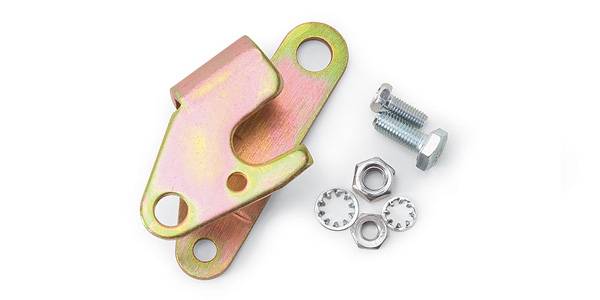

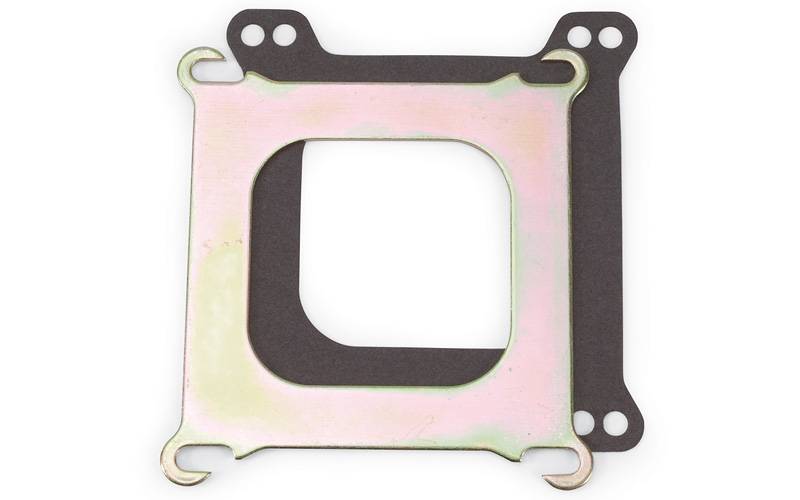

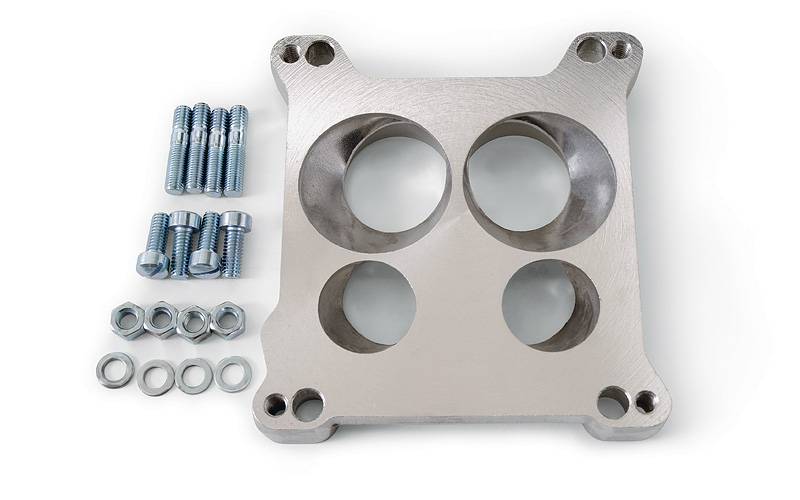

If you are putting a 1406 on a stock Mopar iron TQ manifold you should use adapter # 2696.
If you are putting a 1406 on an Eddie Performer intake....use the plate adapter (# 2732) that comes in the manifold box.
You will also need the Mopar linkage adapter # 1481.
