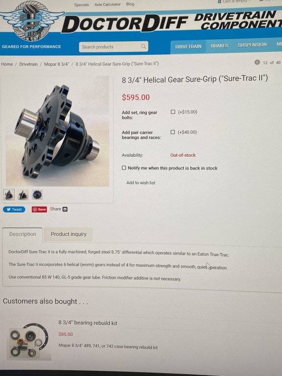

Guys, I've decided I need to lower the rear gear in the Newport. 2.76 rear gear in a 742 case I have now is rather long legged, but Id like more spirited acceleration than what it gives me. Attached are the pictures of what I'm looking at buying. Opinions on going from a 2.76 to 3.23? Tires are 235/70/15 that are 28" diameter. Most driving is in town with some freeway trips of a few hundred miles in mountain territory. Opinions?

Personally I'd go with a 3.55 or 3.73 to feel the most difference, you're running a fairly tall tire so should be fine cruising still. I talked to the guys at Dr Diff about a week ago and he said they should be getting in those helical gear differentials within the next few weeks. I'm waiting on one as well, bumping my ride up to a 3.91 with the change, have 3.23's now and not enough kick in the butt for me still. Also unless you're going to go crazy with some torque monster engine I would't spend the money for the 489 case, your 742 case will be fine. If you had a 741 case I'd say make the change.
