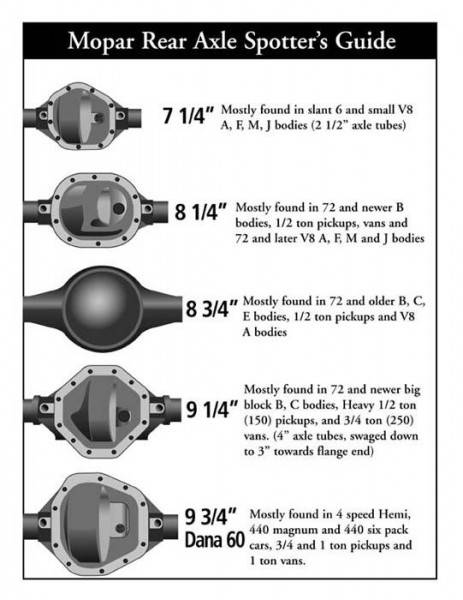

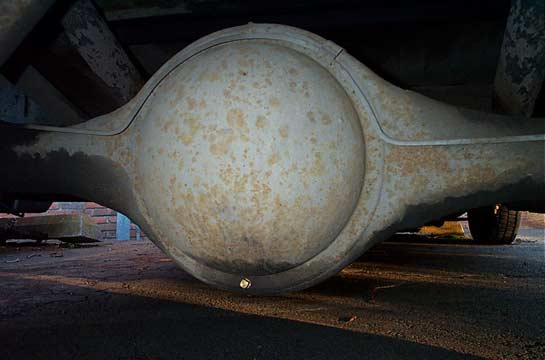

Easy enough to see...
Look under the rear of the car. The 8 3/4 rear does not have a removable cover.
Example:

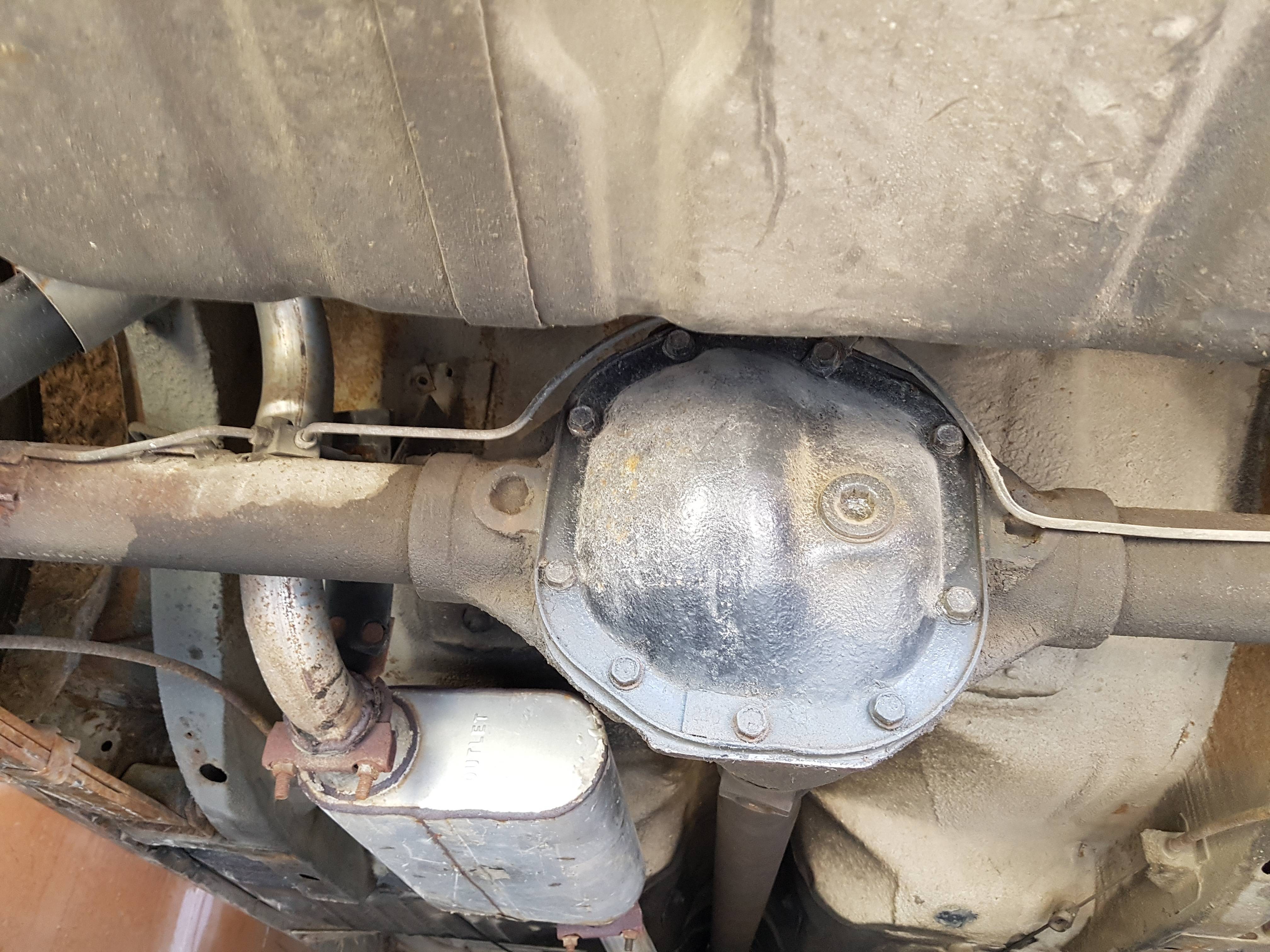

Anything else will have a removable cover.
Example:
