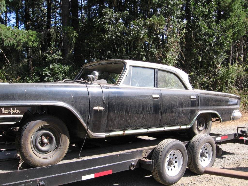

Steve Hobby has a 62 New Yorker and has been engineering the factory pushbuttons to work on his OD trans.
Aka the Blue Diamond,that he bought from Scott Allred years ago.
He should have the prototype ready by this year.
Sorry no pics as he may patent the design.
@Snotty
The old beast looks good! Lot better than it did when he towed it home from Oregon! Yuck!!

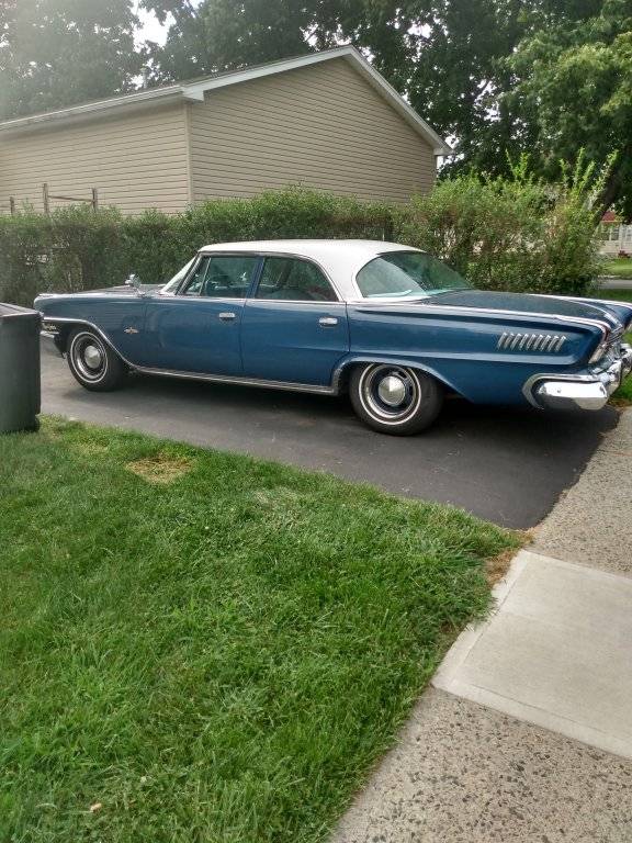

Hey thanks for the breakdown! I kinda already ran the numbers because it is a lot of money for sometimes a marginal gain. It's going to be basically my daily driver, especially running it alot for the summer! I'd love to take it to the beach soon and maybe go over route 66 towards the end of summer.
That's just how the idea started, it's like how much gas are you going to use... with the highest fuel prices ever and what can you do to improve what you have.
I think I just need to give everyone my broader ideas so we can hash out everything together. I do need the pros and cons outside of my own head with other knowledgeable people.
I'm basically building my Imperial to be like a daily driver. It's going to look pretty for a car show, but I need it to preform when I go on long trips. I live in the mountains of Maryland in a very economically depressed town. And among all the hills you have to drive at least 1 hour in any direction to do anything.
The car when I bought it had everything down to the seals... original from 64! I'm going to be tearing down the engine soon and just building it back stock with a few tweaks. I thought while I was doing that, why not work on the transmission.
My uncle has many parts cars like jeeps and ram trucks from the 80s and 90s, so I definitely know I'll have a transmission.
I am swapping all brakes to disks and used the original hubs that I removed from the drums in the rear and keeping the original axles to build the rear. I also need to service the differential so that would be a great time to add the new gears.
Basically one thing leads to another with all this updating and if I'm going to do it, I might as well do it while in the process. If it's possible and something I can see spending the extra time and money on, it gives a good benefit, then I won't mind.
I just need other opinions outside of my own to help give a clearer picture and I'll judge if it's honestly worth the extra effort and cost
Thanks everyone so far! It's definitely helped fill the gaps that I didn't even think about!

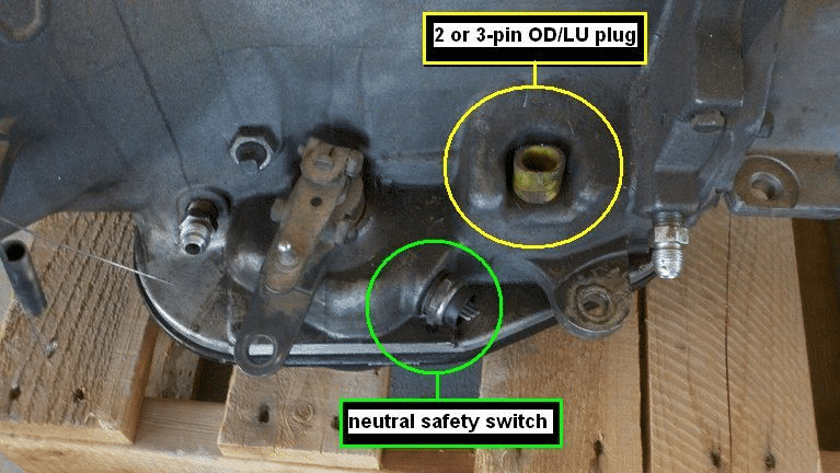

Oh one more thing before you buy the trans make sure you get a pre 1992 (I think) You want the one shown below with the 3 pin, not the bigger 5 pin. The newer trans has a electronically controlled governor and you need a computer for that. The 3 pin you just need switches for the OD and LU.
My 1994 46RH is 3-pin
Does that car have a 2 piece driveshaft with a carrier bearing in the middle? GearVendors has a stand alone unit for trucks that has a yoke on both ends. Even if the Imp doesn't have that type of driveline, it's a full frame car so you could fab up a crossmember to hang the GV on and split the drive shaft.
This accomplishes a few things, 1, you don't have to disturb your pushbuttons, 2, you don't have to buy, build and adapt another transmission and make it fit where it doesn't belong and 3, it gives you a bulletproof OD that you can use to turn your 3 speed into a 6 speed.
