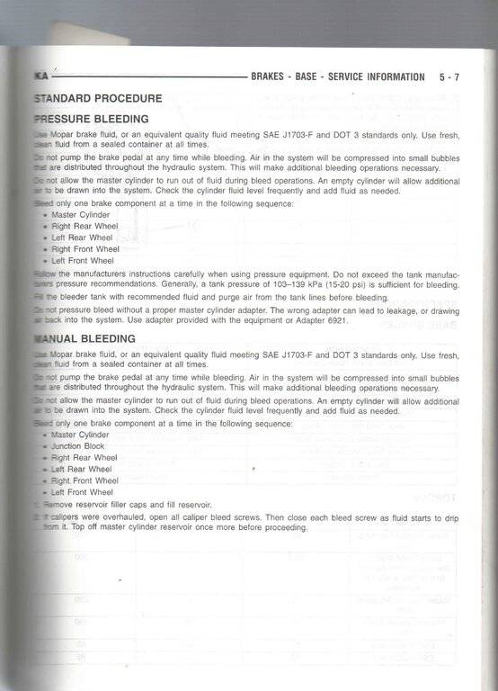

The passenger rear brake caliper on my wife's 2011 Dodge Nitro jammed and began heating up my wheel because the piston could not retract. I followed the factory caliper replacement procedure, including using a piece of wood to hold the brake pedal down so that the master cylinder did not empty. I bled the passenger side rear brake caliper, using single pumps of the brake pedal and a 10 mm wrench to crack it during pumping FSM 5-7. I bled it until no air was coming out of the bleeder valve. I then manually bled all 4 brakes. Again no bubbles

Lots of times, you have a bleed process that involves running the pump with a scan tool, does it mention that?
No, but it is a 2008 FSM and the truck is 2011.
2008 was the last year for factory shop manuals for my truck.

I was careful to block the pedal forward per the factory shop manual’s instructions. I was careful not to pump up the brake pedal but the pump it once with the valve open and close the valve before letting the pedal (operated by an assistant) be released. I have a one-man bleeder kit and I did 4 bottles through the right rear caliper, then another bottle at each of the other 3 calipers. I don’t see how air could have gotten up to the ABS unit, but anything is possible. If Air in the system is the problem, it sounds like it would be simpler for me to pay a shop to pressure bleed the system, then for me to continue to f with it.
