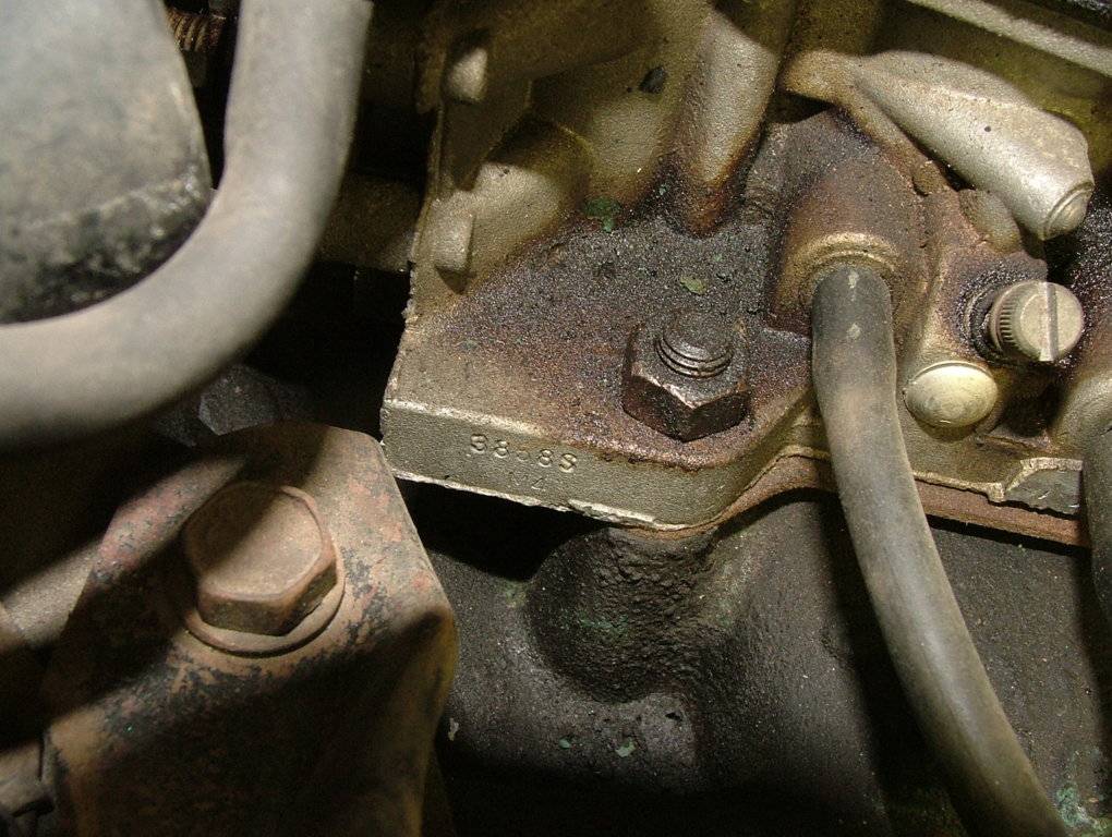

I need some help. My Monaco has the 383 4V with a Carter AFB which I need to rebuild. The number stamped on the lower front flange is 3858S but the shop manual says my car should have a 4131S. A list from one of the carb shops shows the 3858S as being from a 1965 413. Does anyone know what the difference, if any, be between these two carbs, and would there be any problem using what I have?
If I can use the 3858S, any recommendations on suppliers of a good rebuild kit and a new choke pulloff? Thanks for any help you can offer.
Assuming that we are not talking show car here, that AFB will work fine for your application. The 413 carb and 383 carb share the same casting. The jetting if it is still original to the carb on you car is probably a little richer than what came with the 383, but I doubt you will notice much difference.

I don't think these afb's came with tags, the number is stamped on the front lower base passenger side, see my picture at the top.
